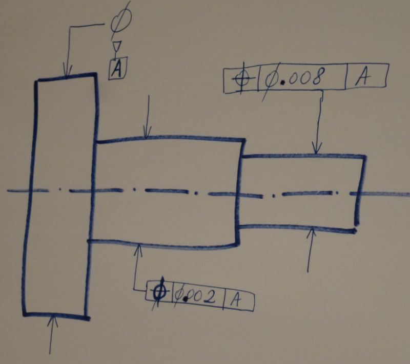

Maximum allowable distance between the axes of considered features located with position callouts is:
a.).008
b.).002
c.).010
d.).005
e.).006

Well, I answered .006 (e) on part 1 question. (.008-.002)
and part 2 was basically a shot in the dark: I answered d (as I had to answer something:)
Now I am doing this: banghead

What are the radii of the two zones?

Maximum allowable distance between both axes is when axis #1 is at maximum possible distance from datum axis on one side of the datum axis AND axis #2 is at maximum possible distance from the datum axis on the other side of that datum axis.
The maximum possible distance between axis of considered feature and the datum axis equals half of position tolerance value (radius of the tolerance zone).
Does it help?

Anyway, I agree with pmarc, .001 radius in one side, .004 radius on the opposite side, therefore "maximum allowable distance between the axes" make it to .005.

Greenimi -- I think those tables were removed because while technically correct, they implied to some people that datum shift is directly additive to the geometric tolerance value (just as bonus is).
And those tables don't really apply to this question since the OP's sketch was all RFS/RMB.
