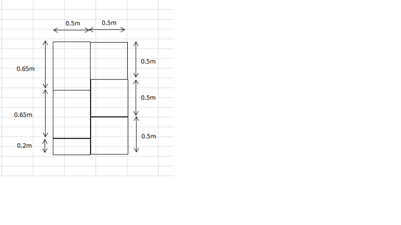

Hi
I have a plate element, which is meshed as shown in the picture given below. Is that a right way of meshing. If not can anybody give a good reason.
If I am having a slab of 7 meter x 12 meter x 650mm thick and going to analyze as a plate element, what is the size of mesh I have to use. Please explain about aspect ratio of plate mesh in detail.

is that the complete mesh ? so the corners of the elements (the rectangles) don't align ? is so the mesh should fail (because it is not continuous).
it is not clear what your structure is, nor why you've chosen to idealise it the way you have.

I just shown an example, I just want to know weather the plates must me connected only to the nodes, why not as shown in the above sketch.

I don't understand your figure. Does your complete mesh consist of six elements?
The elements need to be connected at the nodes. This approach may be software specific but I don't think the mesh will work.

ok, your example is very poor; particularly when you say "I have a plate element, which is meshed as shown".
1) it lacks continuity
2) the mesh is very coarse
3) we don't know where the loads are, where the constraints are, where the limitations of the structure are, where things are that'd affect the mesh, ...
it would be more useful to post the structure you're trying to model and say "how'd i do this?".
expect a bunch of replies like "go back to school and learn FEA" or "hire a component SE".

Your sketch shows no connectivity b/w the elements, meaning that you will have a severed load-path or no load-path at all.

what u are showing in the picture is not consistent with your description of the slab. it is one slab or six slabs. are they individual slabs or they are bonded together which acts as one piece. and the dimensions that u are describing doesn't not match the dimensions in your picture.

I'm going to take a wild guess here, and assume that:
1. You want to analyse an RC floor system supported by beams (probably modelled with plate elements, with line supports representing the beams.
2. You're worried that it won't mesh properly. I.e. each of the rectangles will have their own "mesh" pattern, with "nodes" that don't link up between adjacent panels.
As others have said, you need to be sure in what you want to analyse. Are they one single monolithic slab, or individual slabs? This is going to be extremely software specific, but any decent package will ensure this is something you don't need to worry about for something simple like this ; although the mesh will look terrible, with a very poor aspect ratio).
Yes, the nodes need to connect; the "mesh" is the structure/model, the geometry on which is based isn't considered in the analysis at all. I think understanding the difference between "geometry" and "mesh" in FEA-land will be helpful, going through the manual will be a helpful thing for you to do. Fundamentally, FE is the subdivision of a very large structure into very small pieces (or "elements", connected at individual points (or "nodes"). (please don't burn me at the stake if this statement isnt 100% correct ;), yes I know you can have additional nodes in between etc). If these pieces are not connected, they will act independently.
