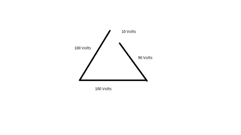

Single phase loads. The sketch of the delta does not reflect the action of the delta with unbalances.
A single phase load causes a voltage drop on that phase. As a result the voltages supplied to the delta are no longer equal.
For the sake of illustration assume that a single phase load causes a 10 Volt drop on a 100 Volt circuit.
That leg of the delta now has 90 Volts applied. The 10 Volt deficit causes a circulating current in the delta, limited by three times the PU impedance. The current in the neutral will be an effect of the 10 Volt deficit and will not be related to the phase or line currents.

"The current in the neutral will be an effect of the 10 Volt deficit and will not be related to the phase or line currents."
Big disagreement here, definitely related to the line currents per Kirchhoff.
"Fundamental frequency unbalanced currents do not coincide on the neutral and add vectorilly. Only the vector difference flows in the neutral."
Now we agree. This summation is 3I0, and the fact that I0 is by definition in phase everywhere makes the math easy. I made it a bit easier by ignoring the only non-zero sequence current present, the negligible amount of magnetizing current of the transformer. Remember the 480 V side is disconnected, so we're effectively filtering out all positive and negative sequence currents.

After reflecting a bit on the notion that unbalanced voltage is needed to have unbalanced current, I don't believe this is true. The unbalanced load causes this current. If we modeled the source as an infinite bus, the single phase load would still cause an unbalance. And for a more real world scenario, we could apply single phase voltage regulation at the load location to balance the voltage drop caused by the load, and we would still see current unbalance.

No problem with the math and with the oscillography posted by jgrist.
Problem with the interpretation.
With equal fundamental currents on all phases, there will be zero sequence current and the neutral current will be zero.
With triplen harmonics the currents add on the neutral.
I correct myself as to the source of the harmonics. The source may be the system or may be the transformer itself.
Given the low impedance of the delta winding to triplen harmonic currents a fairly low harmonic content may result in a higher than expected circulating current.
A time base on the oscillography will show the currents to be 180 Hz. Rather than the phase currents being displaced 120 degrees, the third cycle of A phase is in phase with the second cycle of B phase and both are in phase with the first cycle of C phase.
The delta winding provides a stable neutral when the power-in wye side is fed with a three wire system. That is, the power-in side wye-point is floating.
Circulating currents may be replaced by neutral inversion (a neutral shift away from the expected position) and possible over voltage switching transients.
POSSIBLE ISSUES: If the solar system becomes islanded, you may not have a stable neutral at the 120/208 Volt panel. Feeding the 120/208 volt panel with no neutral connection is equivalent to feeding a wye panel from a delta system.
Your normal operation is power in on the 480 Volt side. Power out on the 120/208 Volt side. The delta will allow you to run with no neutral on the 480 Volt side.
Your solution of opening the neutral is only a good solution when the transformer is being back fed. It may have issues during normal operation.
When the transformer is back fed from the 208/120 Volt side, the combination of a four wire connection and the delta winding will cause issues.
Again the delta winding allows you to feed power in the 480 Volt side without a neutral connection but I understand that you have a four wire connection on the 480 Volt side. If that is true you do not need the delta winding and you may open the delta.

Utilities dislike any delta connected transformers because they can lead to ferroresonance. Hence they prefer wye-wye transformers. But that only works if you have 3 independent iron cores or a 4 or 5 leg core. A typical 3 leg core 3 phase transformer acts as a phantom delta even if a real delta connection isn't there.
There is a small risk of ferroresonance on a single phase condition with that neutral not connected; but it isn't any more than the risk found all the time when delta-wye transformers are applied.
RE: Wye Wye Transformer Grounding/Bonding
Bill,
The current on the graph I posted was the grounding transformer contribution to a single phase to ground fault on the utility system. The frequency is 60 Hz. The currents are all equal but are not 120 deg apart. They are all in phase and add to 3 times the phase current. There is no positive or negative sequence current. There is no 3rd harmonic current.
The transformer could be operated with the 120/208V neutral ungrounded, but not if the 480V breaker is closed. With the 120/208V neutral ungrounded, there would be limited Ø-grd fault current on the 480V side and the breaker may not trip for a Ø-grd fault.
