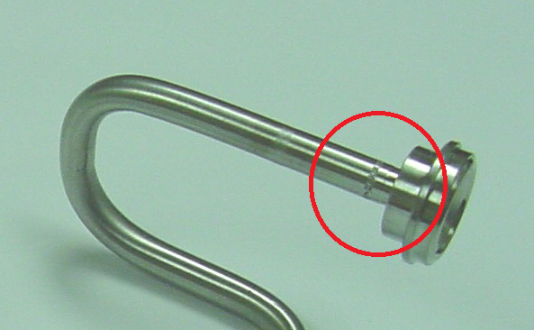

I am looking into orbital-welding the shown stainless-steel part to an ss tube and some couplings. However, some colleagues have expressed concerns that the welding process will warp the tiny, tiny 2 micrometer restriction hole at the end, possibly closing it or making it too large. I have a hard time believing that it will warp significantly (the tolerance on the hole diameter is already 20%), but I how do I convince them of this (if I am right)?
It seems that bending or stretching of the part should have minimal effect. Diametrical shrinkage or swelling would, at worst, have the same effect on the hole as on the whole part, so unless it's in the 10s percents, it won't be noticeable. Not to mention that the heat has a long way and a lot of material to go from the welding site to the restriction hole. We could also reduce the diameter of the tube at the welding site (it's outer diameter is too large anyway). Is there anything missing or incorrect from my logic?

What welding process? EBW?
RE: Warping due to heat-affected zone
Orbital-welded, which is basically a fully automated gas tungsten arc welding process (GTAW).

In the world of designing welded structures for automated machines the common practice is to do all precision machining AFTER welding, but I don't know if that would really apply here.
The way to achieve even a 20% tolerance on such a small hole, is to make lots and throw away the (most) which don't comply. So indeed, we though about doing the machining after the welding, but then the cost would skyrocket by an order of magnitude. These are ultra-clean (thus ultra-expensive) parts.

Not sure, but is the hole measurable after welding on a short tube stub? If so, I'd weld on a short stub to several samples, and measure the hole before/after to verify any distortion. For a "micron sized hole" I'm not sure how many measurements you'd have to make to verify that any apparent differences between the before/after measurements are noise and not a real effect of the welding.
Even if the hole is difficult to measure the operating characteristics should be verifiable. Even if the only reason was to produce something extruded to that diameter, one can measure the product.
Have you looked into adding a temporary heat sink to the part being welded?

If the difference was in the realm of noise, I would just take that as a non-issue, since anyway the tolerance on the diameter is ~20%.
Still, we are nonetheless interested in the end product, which is a very small flow of gas through the hole. We can measure it, and we can do it before and after welding. But, by the time we get this thing shipped from the other side of the world, then get it tested, then get it welded, then get it tested again, then do it all again with a heat sink, +/- bureaucracy and red tape, it will be a loong time. In the meantime, we have a half-assed "plan-b" which we know will work, but it's ugly. And I would like to avoid it, hence the question.

I like Berkshire's ides, make a copper heat sink clamp to put around the part.
I'll wager that if the welding is done correctly you cold hold the end with a bare hand.
It should not be an issue if the delta T is less than 200 degrees F. Thermal gradients below that temperature will produce stresses in the elastic range, thus are recoverable. As the part with the hole in it is some distance away, the thermal gradient should not be that bad. The temperature should be fairly uniform by the time it gets to that portion of the assembly. The alternative is to use a heat sink. What is the material of construction? If it is austenitic stainless. the heat sink is not a bad idea. You could wrap copper tubing tightly around the pipe and pump water through it. I've don't it with type 316 stainless and it work very well.

"...I like Berkshire's ides, make a copper heat sink clamp to put around the part..." and inside the part and not excessively long so as not to cool the weld too fast.
Assuming this is an austenitic stainless, rapid cooling isn't an issue.

The diameter of the flow orifice is incredibly small (0.000079") and the orifice length tolerance is quite tight (0.010" +/-0.002"). The wall of the tube at the butt weld location (0.076") is fairly thick and the OD (0.340") is small in comparison. But there is a fairly large axial distance between the orifice and butt weld location (>1.0").
With such a small diameter flow orifice, the biggest concern would seem to be slag from weld drop around the tube ID breaking loose and clogging the flow orifice.

there will have to be a weld fixture to perfectly align the two parts. then tack it in place. the part is so small there will be excessive heat affected zone. this is a challenge. there will be damage cause by the heat affected zone. the welding will have to be executed perfectly. placing a heat sink would help, but this part is so small it will be difficult at best. I think your colleges have a valid point. and there will be heat shrink from the parent material being consumed. which will shorten the length. but it is so small it may be negligible. the best option is to do test before and after , and adjust as necessary. Inspecting a 8 millions diameter hole ? how is that done by the fabricator. even manufacturing it will be difficult no less inspecting it. is there other parts fabricated this way and inspected? if so get with them and Investigate how it is inspected.

If you have already done the trials and reduction in hole size is the result every time.
One Possible Solution:
1. You can manufacture a fixture, kind of a go gauge for the 2 micrometer restriction hole (I can see tapered cavity on the right side which can hold the gauge).
2. Put this go gauge on, every time you do the orbital GTAW.
I guess this might solve your problem for the reduction in the hole size.

The fabricator inspects the hole size either optically (with a microscope), or by a flowmeter. The flowmeter method is 2x more expensive (~$200).
But since flow is the property that really matters that should be what they test.
I would be pissed to get one that had the wrong flow and be told 'but the hole looks to be the right size'.
I would agree with EdStainless that air-gauging is the correct method to validate the welded assembly meets flow requirements.
I would agree.Air flow test before and after.
Right direction - cooling of the weld zone.
To completely eliminate the hole deformation need the part head with the hole immersion in water and to weld.
