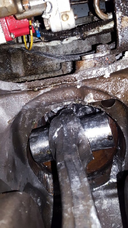

Remember the generator/regulator issue you guys assisted me with a couple of weeks ago? Well, once that generator was shipshape they just parked it on a siding and continued using the Head End Power (H.E.P.) from a 250kW generator mounted transversely in the rear of the F unit (a 'covered wagon' style engine). Well, they did until today anyway. LOL.
With the train waiting for passengers to cue-up for loading the generator was heard to go to full throttle for about 1 second then come off all throttle for about 1 second, repeating this four times before automatically shutting down. Before staff could take five steps in its direction, oil and antifreeze began pouring out of the H.E.P. end of the F unit.
Inspection revealed:
The white stuff is fire department anti-hazmat absorbent.
How about that lump!
I'm pretty amazed a quarter of the piston was actually able to claw its way out of the block.
How about some speculation on what caused this. I believe the load was about 90kW at failure.
Why exactly would a piston get so pissed off as to leave the party sideways?
I didn't have time to gander long so I failed to get the engine type. I'm thinking it's a Marathon tail-end? Anyone know what make engine that is?
Luckily the power car we all fixed was ready. They detoured to the yard 5 minutes away and picked it up and were back in business about 15 minutes later.

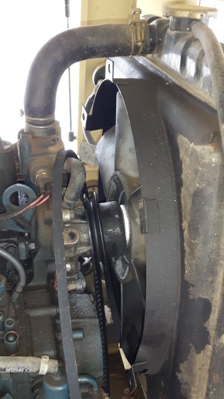

RE: De pain de pain.. Generator retires.
I share your pain.
We had a three hour power outage today.
No problem.
I fired up the old diesel generator and it was business as usual for an hour or so.
Then the hub of the pulley on the water pump and cooling fan broke and the set shut down on high temp. (I hope)
Problem.
The good news is that when this broke 6 years ago, we did a red-neck fix and ordered a new pulley.
I just located the replacement pulley in the bottom of a storage closet.
I should be able to install the new part tomorrow.
Bill
"Why not the best?"
Jimmy Carter
Bill - at least your fan didn't go through the radiator.

Yes Lionel Small mercies.
My problems are nowhere as serious as Keith's but I do envy him the California weather.
I will be doing my best to get this fixed today at minus 7 C. Tomorrows forecast is minus 15.
The set gets a few hours a day use at this time of year lighting up the skating rink in the evenings.

Wasn't an overspeed. All personnel stated it never got faster than it had been running. The excursions were all "down and back". I'm now told there were about 10 and they were pretty quick. No one heard it actually 'break' since they were all standing a bit farther up the same locomotive who's prime mover was running.
I went by last night to see if I could get a picture up inside the engine through the new 'inspection port' to see if maybe the valve head(s) are gone. That would lend some 'points' to Bills dropped valve scenario. However my contact there had just hiked back 200 yards from that locomotive to the afore discussed power car on the other end, where I'm contemplating a solar charger to keep the batteries topped up over the 11 month idle period. I could see on my buddy's face the four back-to-back 112 hour work weeks were really flagging him and opted for doing it another day.

Get your Generator back together Bill?
I got back to the local shortline and stuck my camera in the hole in the block to 'see' up into the cylinder. Forgive the quality the train when in motion just after I got down to take the picture.
I'm thinking it maybe wasn't a dropped valve unless that's not what I'm seeing.
The 350HP Cummins was delivering ~ 120HP and had been steadily (+/- 25HP) for the last 3 hours before checking out.

For a moment I wondered if the injector caused a hydraulic lock. Once the piston was gone, the fuel would have run out, eliminating some of the evidence. That would explain bogging down, and with too much fuel not all would burn, so it would take a bit to refill if it managed to puke any out the exhaust valve. Alternatively a leak of coolant into the cylinder can cause loss of lubrication (I used Google to search for hydrolock of diesels and found that.) Another suggests too much water in the fuel can build up.

Thanks for the pics.
All those impact areas and the bends in the con rod explain the throttle burps.
Every time the con rod hit something solid the engine would slow enough for the governor to open the throttle.
Mine is going slow. Not difficult just slow.
It seems that I have some damage to the flange on the water pump.
I couldn't repair it in situ.
I now have a replacement pump with all the spacers and a new fan.
We had a few days of colder weather and it's mostly bare finger work.
Today is a hockey tournament.
There's a good chance it will be fixed tomorrow.

I have seen a $10,000 con rod bent a little worse than that, but it was from a 'crash stop' in a big yacht with a suboptimal exhaust riser.
... i.e., hydraulic lock, which could be caused in any Diesel by a coolant leak into the cylinder, or mechanical lock, as from a valve head separating.
I think I can see two valve heads in their proper location in that last photo.
It's interesting that the piston pin and the small end of the rod appear to have never left the vicinity of the cylinder, suggesting that for whatever reason, maybe just old age, the piston fractured, and was then beaten into a lump, which then eventually found a weak spot in the crankcase, leading to a shutdown for loss of oil.
I have had a piston fracture at the oil ring groove, but the lump in the photo with the rings embedded, suggests that maybe yours fractured at the pin boss.
I don't see proof that the water jacket was breached, and I have seen bailing wire type repairs that worked against all odds, so I can't say it's impossible to return the engine to service; it just depends on how motivated and how stubborn your guys are.

Based on your pictures and info this looks like the piston seized in the bore, finally stuck hard enough for the rod to pull the piston apart, the free rod small end and piston pin beat the lower part of the piston and the liner into pieces and when a big enough chunk of the piston or liner got free and came down between the crank and the side of the block it got kicked out.
Have seen a lot of these failures in diesel engines over the years, the causes have been widely varied, usually cooling system problems accounted for most on engines with higher hours, even at low load factors, signs of that was usually corroded and pitted water sides of the liners. Actual "single hole" failures were usually the result of fuel injection nozzles or unit injector problems. When CAT first came out with high pressure unit injectors, we had a fairly large number of failures due to water in the fuel, would cause the injector tip to fail, wash down the cylinder and stick the piston. Had to re-educate may customers who were used to the older type engines that were very fuel tolerant into taking better care of their fuel. About the only time I have seen piston seizure due to lack of lube is on engines that use piston lube oil cooling, I don't think your Cummins engine has that. Generally lack of lube affects the rod bearings, rear main bearing and cam lobes/followers (more heavily loaded surfaces in the engine) before running long enough to seize a piston. Lube oil quality problems causing excessive deposits can lead to seizure, you may find one hole ventilated the block but the other holes weren't far behind in those cases.
A lot of possible causes, if you really want to understand the failure you need to pull the head and pan and look at the adjacent cylinders. This will help determine if a systemic problem, such as lack of lube or coolant was the culprit, of if the event was confined to that hole. Try to gather as many of the pieces as you can, preferably before they all rust up, try to find pieces of the piston skirt with minimal impact damage to get an idea if the surface, same with the liner pieces, and make sure you look on both the cylinder wall and water side of the liner, could help you determine if the problem was related to cooling system issues or problems internal to the cylinder. Cummins published Bulletin (985579) titled "Failure Analysis Pistons and Liners", here is a link describing,https://books.google.com/books/about/Failure_Analy...
Caterpillar also published a failure guide for pistons, liners and rings, form number SEBV0553
I was pretty surprised to see that also.
Quote (MikeH)
Would this change your opinion? LOL
Quote (MikeL)
The rod end in the picture above did exactly that. I believe I can see aluminum imbedded in the con rod in the 8MB image.
