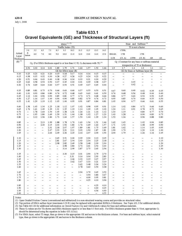

Requesting further clarification:
Caltrans Empirical method for flexible pavement design(based on Hveem method, I believe) uses GE (gravel equivalent) and GF (gravel factor), in addition to TI and R-value (not CBR).
Table 633.1 attached. There is a "credit" for thicker aggregate base (reducing HMA). How is that different than AASHTO? Learn me.

ATSE - HMA is flexible pavement, not a concrete slab.
RE: Gravel under SOG
cvg - we can agree on that.
The papers included in EC118 included both rigid pavement (plain concrete) and flexible pavement (asphalt) - lots of material there - I didn't read it all.
So OG and Ron's comment apply solely to concrete slabs for pavement.
