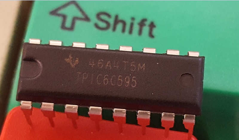

So recently due to the low temperatures and in turn the low humidity I have been seeing this weird thing where if you wiggle too much in a chair near the circuit-board and power system I have been working on, then stand up, you create a pulse in the ground of the system which is strong enough to toggle the clear pin on the boards shift register.
The chair is according to my DMM isolated from the floor, and the person standing up needs only to either zap themselves by touching the chair or sometimes just walk away from the chair in the correct direction to recreate this.
I am not an amazing circuit board designer so I am guessing I made some simple error that anyone with experience would know not to do.
All of my ground planes are connected. They were in a web style connection earlier, but I tried moving the shift register to a point style connection on solder-less breadboard and still had issues.
All of the grounds are also connected to earth ground through the 120VAC 3 prong plug GND as well as the chassis holding everything.
The 120VAC comes in and goes to a switching 24VDC PSU which has negative jumpered to earth ground. That then goes to a motor controller made by ZABER with 4 DO pins and an analogue out with a 5VDC pin which I use to control the shift register.
I have tried adding caps between the 5VDC and GND, I have put a resistor and caps between the 5V and CLR pin and CLR pin and GND respectively.
The shift register in question is a TPIC6c595 although I don't think its particularly important to the question.
Any suggestions?
Thanks.

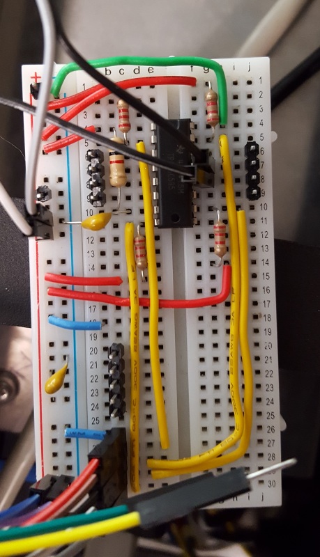

So I tried a low pass filter with a 1kohm resistor and a 1nf, 2.2nf, and then a .1uf cap with the issue still being reproduced. I started a decade away from my measured frequency which was 1/600ns or 1.66MHz.
My caps are through hole, so I got them as close as I could using the solder-less bread board, but they were in no way as short as possible.
I think the ground plane having issues is definitely a possibility.
Is there an easy way to measure the ground plane issues?
All of my devices are earth grounded through the 3 prong plug powering the 24VDC PSU and in turn the board's GND.
How can you measure voltage bumps on earth ground when you don't have a clean ground reference to compare it to?
I can't really include the surroundings, but I can include a picture of the board I have been prototyping off of.

Geez dude.. Those proto boards are for the birds. They have these type issues ALL the time. The logic you're using in very fast and not really applicable to proto boarding. You should resort to grounding thru a 1 meg resistor the person sitting in the chair to the chair with a wrist strap. In other words stop the zaps rather than try to protect a very low quality proto setup from EMI/ESD. You are going to spend a lot of effort on something that won't be a problem otherwise. This is like trying to paint and buff-out a car being picked up by the junk man in a week.
Keith Cress
RE: Static Electricity creating pulse on ground that is clearing shift register?
@MacGyver How do you measure ground? I was having trouble with this as I need some stable reference to measure it relative to correct? I tried running an extension cord to another farther away socket and still got garbage when using the oscilloscopes GND vs the boards GND.
@itsmoked The solderless bread board is my attempt to fix a printed circuit board that was in use and was having the same issues. I don't want to get more boards printed without knowing what the issue is so I have been prototyping it up. Due to the fact that the issue is still there I am guessing its not a solder-less breadboard issue, but once again I cant be 100% sure as there are changes on the breadboard that aren't on the current board.

It could be that the schematic has a slightly different chip package than the breadboard. I ran out of the other chip package so I have been testing with the C version.
I'm spending WAY more time looking at this than I should. What company manufactures your shift register so I can look at the ACTUAL datasheet... this is not a TPIC, as far as I can tell. Also, if the pinout you provided is correct, your serial clock line is pulled up through a 2.2k to power. Your CLR pin is tied to GND through a cap, which means it isn't tied to ground.
I stopped looking at that point... your schematic and protoboard do not seem to match in multiple spots.

Link this is the link to the chip i'm using's datasheet.
The schematic was what was originally on my printed circuit board before i started protoboarding it to make the changes I thought would fix the problem, hence the differences.
also I just reread your last comment: I don't want the clear pin to be grounded, I want it to be always at 5VDC, the issue is that it was having low voltage pulses causing the reset. the 2.2k resistors are pullup resistors because the controller's logic is current sinking not sourcing.

I tried the ground plane without success. I was unable to implement the one common ground point so I did not try that, but it seemed like it might have gotten worse when I used caps between the sheet and gnd and when I just connected each bus to it directly.
I have recreated the issue using an arduino so that is what I am not testing with.
I have taken the board and the arduino and put them in a box that I covered with aluminum foil and grounded and still had the issue.
I added some weird Diode low pass filter combination to each input pin and that seems to have helped, but not fully removed the issue. I haven't fully tested weather it is the low pass filter or the diodes that are making the difference, but from the little I have tested I think the diodes have helped the most.
here is what I can still get on each input pin using the oscilloscope.
