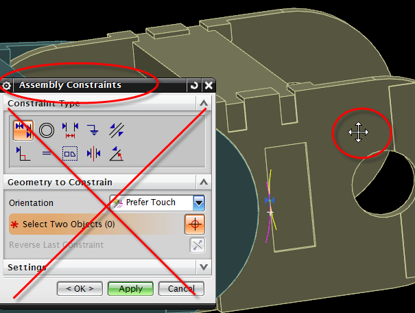

How its to bad that touch constraint is not a real touch
and is also an imaginary touch.
because if it was only a real touch we cood do limited rotation to some angle
as seen in these pictures.

With only pictures, I'm left to assume the beige component has a boss going into a hole on the dark green component and the boss is probably (again, this assumption due to images) the same height as the dark green component is thick in that general area - is this all true? So I can touch the 2 planar faces then align the boss with the hole axis. Once that is done, why do I need another touch? I need to define the angle between the 2 pieces, not touch 2 arcs together - or once again are we missing information the images do not provide?
Post parts if possible, please - makes it easier to see what you've actually done when you don't take us through each step.

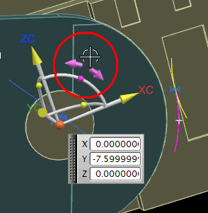

A work around is to use a spline for the cam curve, then the solver will prevent the point follower from moving beyond the desired range.

Working as intended, the assembly solver prevents motions in constrained directions. If you need the chain to follow a certain path i would constrain it to a spline with the minimum radius derived from the allowable degrees rotation of the chain links, this would also allow you to skip the previous mentioned "workaround".

I played around with this quite briefly.
- smart move there to use the Join Curves to convert the Arc to a spline , i would not have thought of that option. smile
( otherwise i am kind of "allergic" to the Join Curves, I see it used ( ex Catia people ?) as a selection method, which isn't that good since it will create an approximation spline on top of the original objects rather than a "selection group".)
It seems that it doesn't need the sharp corners shown by Petulf. If I edit the Join Curves and remove the lines , it works the same.
Anyway, a little trick to avoid the handles of the Move Component.
( - If I pick the "ball" on the arc I can rotate freely, i do not need to move the handle.)
Start the Assembly constraints dialog instead of the Move Component. Then place the cursor anywhere on the component to move, press and drag. It will move within its possible limits.

Toost, cool did not think to check if one needed a discontinuity or not, using only the arc makes the entire thing cleaner.
As for join curves I mostly use it for these sort of occasions IE when constraining something(sketch/asm) to a curve and there is no selection rule available.

RE: To bad that touch constraint is not a real touch
I removed the corners lines (arc spline only)
and start the Assembly constraints dialog instead of the Move Component
and the drag works smoothly.
