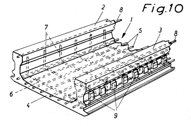

I have no knowledge nor experience with the product/technology, and there is little info on the internet, except some patent info (originally from Sweden and Finland by NILSSON):
It appears to be an extruded U-shaped, trough-section:
Quote (Google)
The Nilcon concrete element consists of a channel-type modular structural section formed by extrusion of concrete containing a wire mesh. The channel contains rock wool insulation and can have sufficient depth to house heating and cooling ducts. A concrete cover section completes the structural section. The units can be used in floor and roof construction, provide acoustic isolation and thermal insulation, and can be used for heat storage, especially with solar heating systems. It is claimed that optimum usage of Nilcon insulation and heat storage capabilities with proper window treatments and heat recovery techniques can reduce building energy requirements for heating and cooling to less than half of that of conventionally constructed buildings
