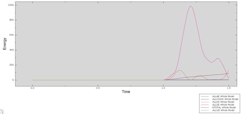

Have you checked the energies (history output)? Maybe they can give a clue.

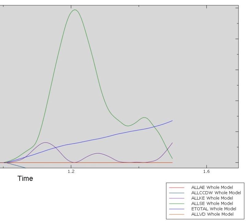

Here is the plot of the energies:
What can I see is that:
- the total energy (ETOTAL) is linear (and may be this is not good thing as I remember that should be better if it was constant).
- the artificial strain (ALLAE), the damping dissipation (AALVD) are negligible compared to the strain energy (ALLSE) (and that is good as I remember)
But I don't catch any clue.

Is it ALLVD that peaks at the end? If you are using damping, try reducing it and see if it makes a difference.
If you are using implicit dynamics you can try changing the energy dissipation in the step (presence of contacts for example defaults to a rather high energy dissipation).
Explicit is the usual (mass scaling, double precision...).
Please let us know how you solve it.
Good luck!
RE: Moving load model in a simply supported beam
Thanks for the interest.
The ALLKE peaks at the end. The ALLVE is constant to zero. What does it tell that?

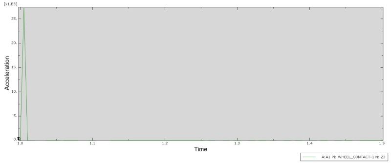

I am not sure why you chose to specify displacement (with a ramped up time variation), instead of constant velocity. This is quite likely transients in the beginning and the end of Step-2 because of unwanted acceleration. Plot the double differentiation of the displacement output (preferably, history output).

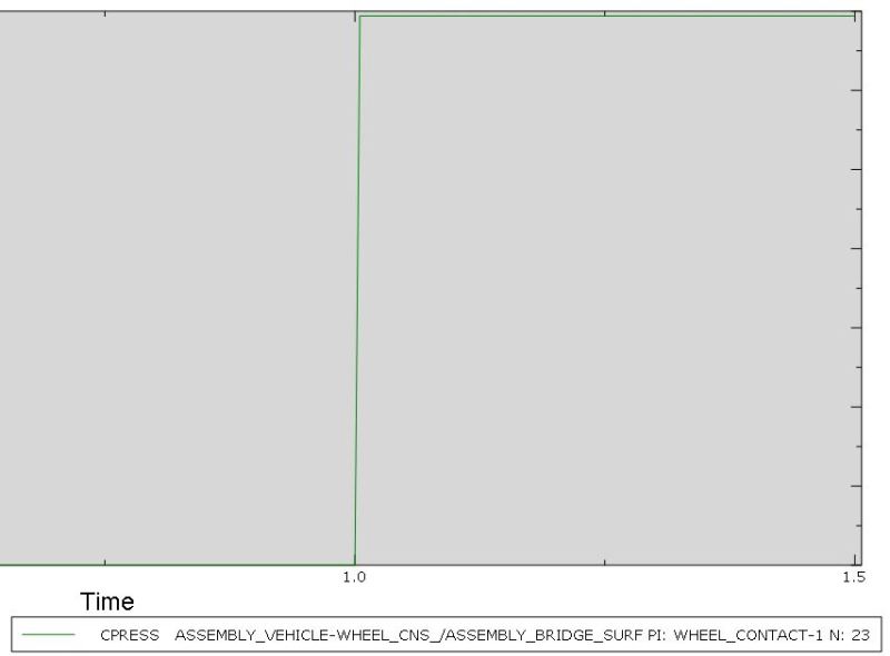

1. The contact pressure between the contact point and the beam

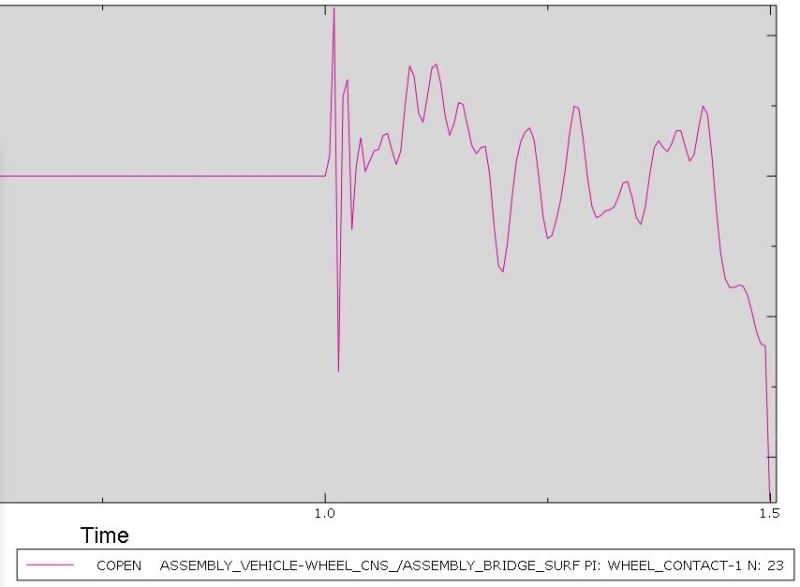

2. The contact open between the contact point and the beam
3. The acceleration of the contact point
It seems all right to me the acceleration.
I have checked with and without the interaction properties "allow separation after contact" but I have the same result in terms of the contact opening.
I really don't understand what is the problem. It seems a really easy model to do but it is actually very tricky...

Your beam has a certain thickness and COPEN seems to show penetrating surfaces towards the end of the analysis and a bit of noisy response, in general. I am not sure if contact is taking the thickness of the beam in to account or not. You can request Abaqus/CAE or Abaqus/Viewer to display the beam thickness and see what I am trying to get at.
Also, read "Contact diagnostics in an Abaqus/Standard analysis" in the documentation for some diagnostics.
I am curious why you need to discretize the domain with 100 beam elements. Can you not get away with just one beam element? If not, why so?
