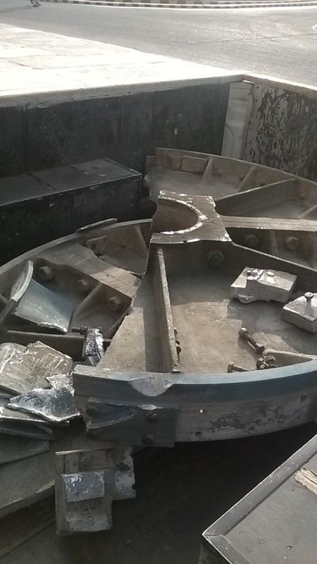

Recently during startup of Generator after oil change, its cooling fan got damaged. I have following queries:
1. The weight of fan is about 170 kg. Is this fan used for cooling of Generator only or is it used as fly wheel as well.
2. We are going to get this fan casted from local market. In the mean while, is it safe to run the generator in case of emergency requirement by application of external air with an arrangement of hose pipes and external industrial grade fans. Insulation class of Generator stator and rotor windings is B.
3. How can we re-design the fan to make it light weight and less prone to damage, while providing the same cooling air to Generator.

That picture helps immensely - it isn't what I had envisaged your problem to be. My opinion would be to fabricate the fan from sheet / plate rather than attempt to cast a fan of this size - you will have far better control of the key performance characteristics and the resulting fan should, if correctly manufactured, be both stronger and more efficient than the cast fan.

This is the damaged fan which was connected on driven end of generator. Can anyone comment is it only cooling fan or flywheel as well??

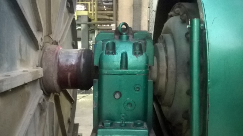

This is the location of fan originally installed on alternator near coupling.

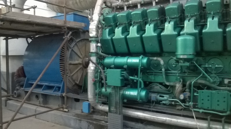

This pic shows complete engine & alternator.

This machine is coming up to the 40 year old mark. Unless it has been rewound lately I would treat it gently.
I would be contacting fan manufacturers to see if an off the shelf fan is available with similar performance specs. It may be easier to modify the drive hub than to fabricate a fan from scratch.
You may want to add some shrouding to direct the air between the fins.
Possibly the original fan had a shroud that may still be used.
Simply direct the air supply to the opening where the air was originally drawn into the fan.
It may be safer and cheaper to forget the fan and use the external air supply permanently.
As long as there is enough air flow in the proper place to keep the generator cool, the generator will not care where the air comes from.

The more I look at the wrecked fan the more I think we can only see the rear face of the fan disc complete with stiffening ribs. The side hidden from view must have been provided with radial blades like those fitted to pretty much all TEFC machines. Presumably these have been smashed off during the event? If the fan is aluminium then I doubt it was intended as a flywheel.

It was an axial, not radial fan. The blades were bolted to the outside circumference of the fan disc. You can see a pitched blade with base plate resting on top of the broken disc. There is a base plate still bolted to the OD at the bottom of the picture with the pitched blade sheared off.

That looks so much like someone took a welded fan and used it as a pattern for a cast fan, practically straight from the Lincoln Arc welding book on replacing castings - the ribs aren't what I would expect from typical casting techniques; sharp edges and small fillet radii, and all those small gussets.
With that in mind, perhaps return to having a new one fabbed as a weldment with decent materials. It could be all one piece that is sawn in half after the main fab is done.
As to the failure, it looks more like either a fatigue crack started at the hub and this failure has been waiting to happen, so nothing else should be directly affected, or someone pushed something like a fork-truck into the fan and exposed everything there to a huge side load.
It doesn't look like a torsional failure, but I haven't seen all possible failures.
In either case, identifying the exact failure mode should be a high priority in order to understand the requirements for a replacement.

An old crack has been found in the fan, which has dust ingress. This shows fan was damaged due to starting jerk which old crack couldn't bear. Fortunately no one was hurt in this incident.

Compositepro,
It is certainly not an axial flow fan, it is a centrifugal (radial) type. An axial fan passes air through the blades along the axis of the shaft, something which is clearly impossible when the fan comprises a solid disc.
I think we are looking at the reverse face of something similar to this. Coincidentally, this is also a cast fan which has broken in half.
Hoxton - wow! Was that a machine from a reputable manufacturer in good repair which suffered the damage? I haven't come across that as a failure mode before at any size or rating. surprise

ScottyUK - a closer look at the disk will show a pad on the rim that looks a lot like an airfoil. Then notice there are a number of smaller bits that also look like airfoils. The really big, disk shaped chunks are the central disk to hold the fan blades that were broken off when the disk ruptured.

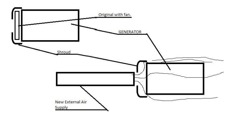

This is the arrangement prepared to cool the alternator in absence of cooling fan. The air pressure is 4~5kg/cm2 and air flow is 7~8 m/sec measured on driven end side of alternator. Please comment on this air pressure & air flow, will this be sufficient to cool the genset on load?? Ambient is around 25 deg celcius max. 2 industrial blowers have also been installed (as shown in pic). The correct insulation class of winding as mentioned on name plate is F (wrongly mentioned above as B which was from data sheet)
We plan to start the genset without excitation initially and measuring all parameters like bearing & winding temp, vibrations etc. The shaft is being fitted with half key balanced.
If everything goes well, then we will load it upto 0.5MW and measure all values. Meanwhile the fan is under casting.

That looks good, however a lot of the air will probably be deflected out sideways. A shroud to direct the air through the cooling slots will give a dramatic improvement economically.
Good observation... I couldn't figure out how this fan was supposed to work until I read your comments.

I suspect that the majority of the air is not going down the slots where you want it.
Compare the air flow at the fan discharge with the air flow out of the slots.
Shrouding?

3Ddave,
You may well be right - apologies Compositepro.

The air from that fan will hit the stator end and be deflected - you need to form a pressurised plenum between the fan discharge side and the stator casing.

Yes, you definitely need ductwork between those fans and the alternator vents to force the air through the alternator.
I would bet money the old fan was an axial fan. The disk in the picture is the center hub and the blades were around the outside so the blade length was the same as the width of that cooling vent opening ring. If you look at the picture posted with the PM in the foreground, the disk would be approximately the size of the part of the end bell inside the vent openings with the blades reaching the rest of the way to the outside of the frame.
RE: Diesel Engine Driven Generator Operation without Cooling Fan
ScottyUK, It took a couple of looks for me to get it. It's a puzzle with a lot of pieces gone. It must have been exciting with all that metal zipping about; lots of chance to injure or kill someone.
Lionel,
Have a look at the photo again: 3Ddave is right (as is Compositepro) - there's the remains of a bolted-on axial fan blade (highlighted) and to the right of it are the marks where others have been smashed off. It's a peculiar fan for an odd-looking generator. Axial fans are typically used inside the machine, forcing cooling air from the stator ends into the airgap and venting air outward through the stator core slots, but radial designs are more common for the external fans where a cowling is used. Not in this case though!
Yes, that's what I posted??? An axial fan with a big hub and little stubby blades. I would be quite wary of another cast replacement fan unless the casting company has the proper experience and engineering to ensure the new casting will survive without failing like that fan did.
Clearly, the axial fan's 'buckets' were cast individually, and bolted to a large central rimmed disk, which appears to have been fabricated from plate and bar, joined by welding, and split for radial assembly.
On the disk, I don't see the draft, fillets and radii that I would expect to see in a single large casting, or two large cast halves of a fan cast with integral buckets.
I can't find an indication of a drive key on the shaft, but the photos do not provide complete coverage. Where the fracture surface intersects the central bore, the near side detail looks a bit like the remains of a keyway.
... which is where it should fracture in a bad sync event.
... and not in a startup, ever.
... but a bad sync event that was bad enough to fracture that fan wheel just against its own inertia, could cause a lot of other damage.
HAVE YOU INSPECTED THE ENGINE CRANK AND INTERNALS?
Today we have successfully test run the generator without cooling fan and with above arrangements:
Max Power: 1.46 MW
Max winding temp: 70 deg celcius
Max Driven end bearing temp: 56 deg celcius
Max Non Driven end bearing temp: 45 deg celcius
Max vibration on generator bearing = 5 mm/sec
That's nearly full load!
That was with the two fans and no ducting?
Did you confirm the temperatures actually stabilized and reached steady-state?
Keith Cress
Yes, the test was performed without fans ducting. Actually as rightly pointed out by everyone fans without ducting were of no use. I switched off the fan after sometime, and it made nearly no impact on the temperatures.
Test was performed for about 2 hrs, and yes temperatures were stabilized. Air spargers helped alot and fans like this were of no use.
Thanks all for your continued support. We hope to get fan casted & balanced in 2 weeks time and after that it will be installed back.
I am very surprised FARHANRAZA by the results you report.
Thank you for keeping us informed. Thanks for the informative pictures too. We all learn that way. Good luck with the new cast fan! We'd like to see it when it shows up.
