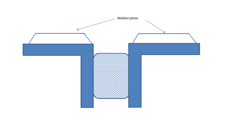

In Connecticut, the DOT would sometimes weld narrow plates along armored joints to raise the blade and prevent the seal from being ripped out. Installing armored joints for a 1" opening isn't worth it, in my opinion.
[img ]
