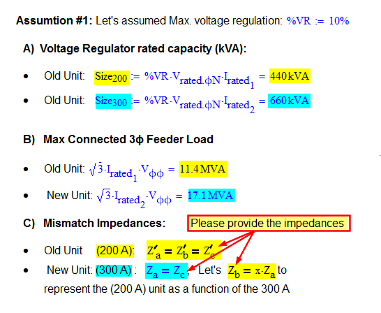

Please provide the impedance of the new and old voltage units. Perhaps this will allow some one to help you with concrete answer if there is not issues connecting the voltage regulating transformers.
In the meantime, let us know the following background information:
  • Why the 200A units were replaced by the 300A rated units?
  • There is any issue with overvoltage or large harmonics (3rd & 5th harmonics could be an issue for Y connection)
  • Is the connected load greater than 11 MVA?
below are a few remark and extra information that I hope could be helpful to advance this thread from good opinion to more concrete technical answer:

Hi MADNCE,
The large unit appear to run above the 20MVA load current rating. If one of the larger unit is substituted by one of the smaller regulators, the situation to be at risk to operated at overloaded conditions even without considering the effect of potential circulating current and the impact of the 3rd & 5th harmonic derating effects.
Did you considered to run temporarily in open delta with a reduced capability?

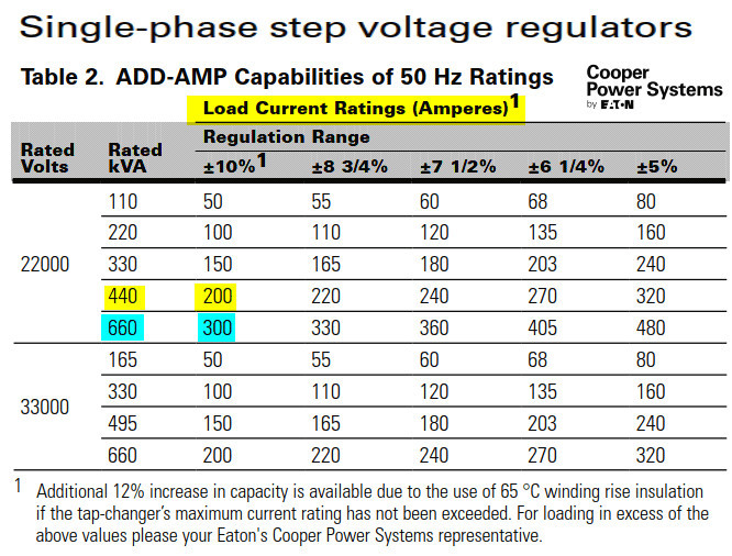

Could you please clarify the rating provided earlier "200A regs @ 22kv rated and 300A regs @ 22kv rated" connected to a 33 kV delta system (Phase-phase-to-phase).
See a typical voltage regulator rating below.

Provided you are not overloading the replaced 200 A unit ( ie keep all 3 phase units to 200A only) you can test run with 1 number 200 A unit and 2 nos 300 A units as a bank. Believe these are auto connected units with solidly grounded neutral. When 300 A unit is working at 200 A , the % impedance reduces to that proportion. Up to 5-10% impedance variation will not create any problem. You can easily check the impedance at site. Apply a small voltage on primary with shorted secondary. Extrapolate voltage for rated current of secondary. That applied voltage as a % of rated primary voltage is the % impedance.
