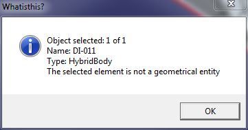

I am also interested in this topic. I know that something can be done, since custom commands and tools that interface with Composites workbench do exist on the market. Perhaps, as Jenial says, not for "users like us".
To the standard VB scripting interface, entities related to CPX are totally obscure. By querying them with my script that writes out Type and checks for geometry class, it says
for a ply
and
for a Contour. Note the reading of HybridShapeThickness, which is a Part design's THickness command. It has no sense.
