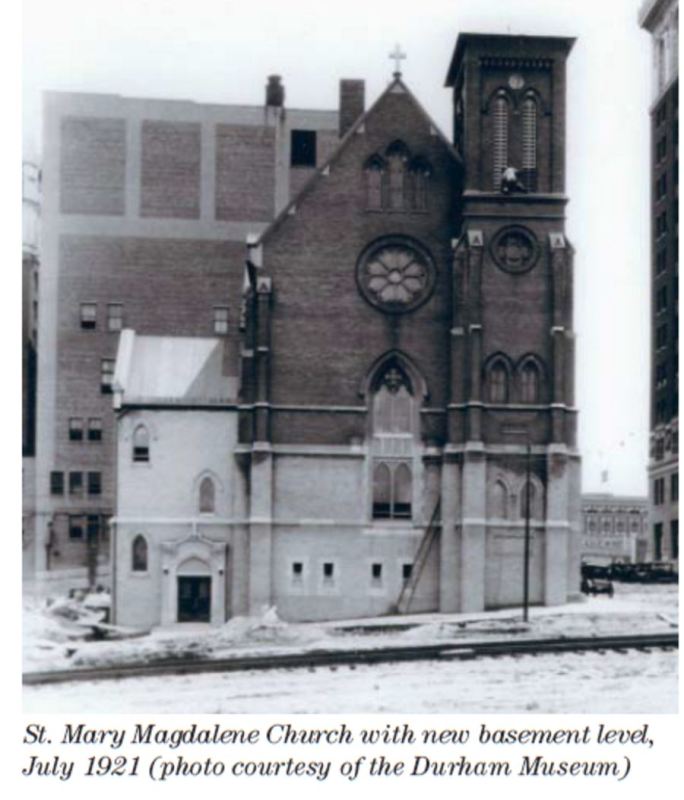

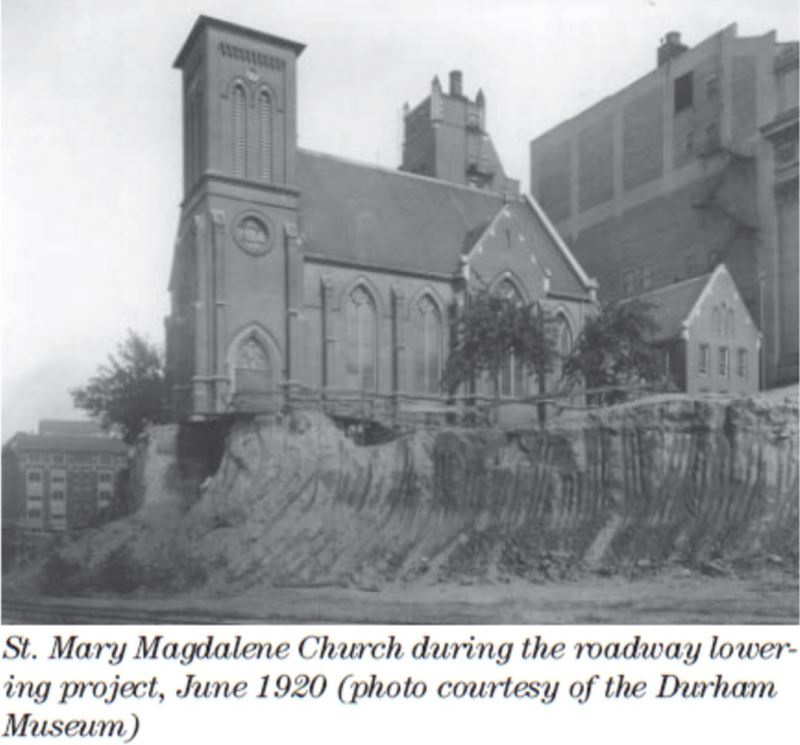

Just came across these two photos of a church project where the street had to be lowered about 10 feet or so - right next to an existing brick church.
They simply dug down and extended the foundation walls lower to accommodate the lower grades.

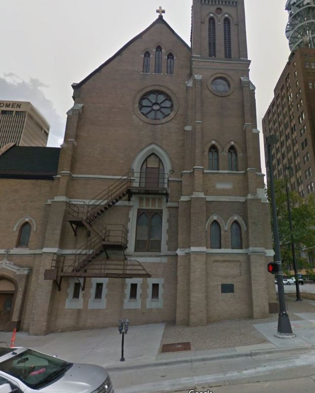

Here's a modern day street-view of the same elevation:

Where exactly is this church located?
It would also be interesting to know if the addition to the church (on the Left) was done at the time of the 'underpinning' since it would appear that since the street was being lowered by MUCH more than "10 feet or so" that it would appears to have been the side where the main entry was located, with what I would assume was a set of steps down to what was then the street level, which is now an emergency exit. In the more recent picture showing the addition, you can see what could be the new main entrance. Of course that would also mean that unless there was some extreme reworking of the interior, that if this building is still being used as a church, that the parishioners must have to climb some significant stairs inside the building to get to the nave. Granted, they could have re-purposed the backside of the building with an entrance if the grade does rise on the backside to the level where it might have historically been before the removal of the soil around what appears to have been the side and front of the original church plot.

This is in Omaha, Nebraska.
Here's a brief history description of the street lowering:
The grade of Dodge Street past Central High School was lowered
from 12% to 7%. The work stopped traffic for more than a year
until it was completed. The new construction left the school on a
sheer cliff with a 20-foot drop. Later, new terraces and flights of
stairs restored the campus to its current appearance. Farther east,
St. Mary Magdalene parish had to build a new first story under the
church when the city lowered the Dodge Street hill at 19th Street.
When the street lowering project was completed this year, Dodge
Street near 20th Street was 36 feet lower than it was in 1880.
Here's a couple other shots - JohnRBaker it looks like you are correct that the small addition on the left was done at the same time as a lowering:

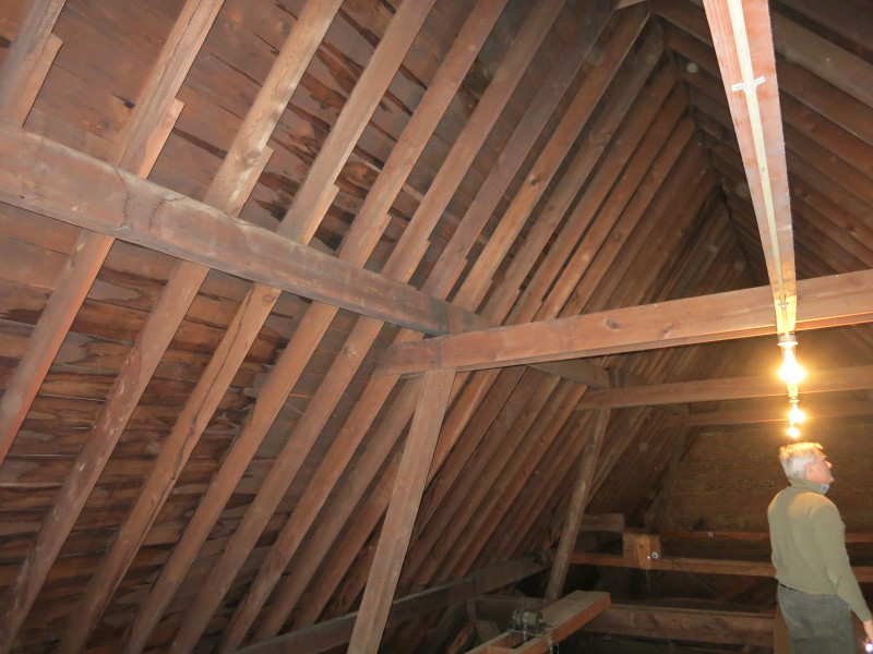

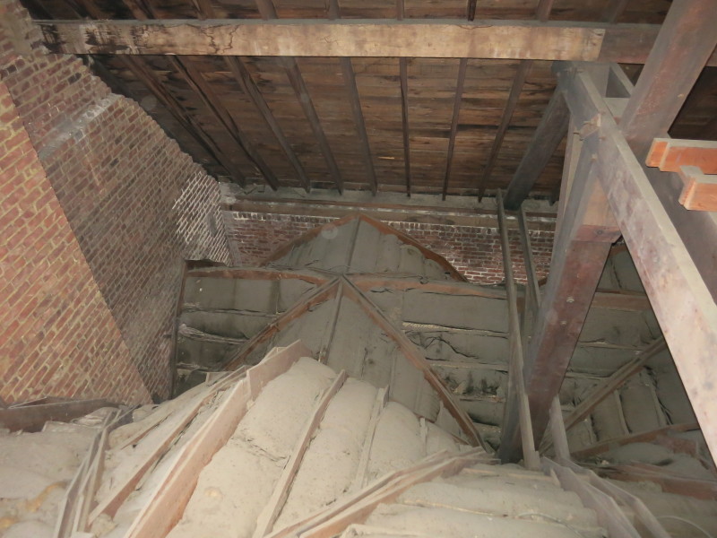

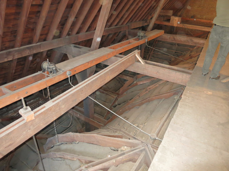

Just a couple of interior (attic) photos from the top roof area. Nice old wood framing.
RE: Underpinning - 1930 style
Great photos JAE... notice some areas of water penetration. This should be looked into to avoid brown rot (aka dry-rot). It would be a shame to loose such a nice framed building.

The lowering of the streets also left City Hall standing way above the street. If I remember the photos I saw, it was in the middle of the block, so they didn't have to excavate close to the building. The soil is loess, underlain by glacial till. The loess is noted for standing well in vertical excavations.
