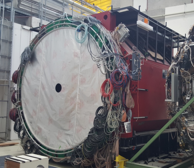

Hi everybody,
We have an old magnet with a big yoke we would like to reuse for a new test. It is 25 years old. We got some drawings (paper drawings!) but there is not information about the material; what steel it is.
We want to run some simulations and we need to know the properties.
How easy is to get a sample, send it to a lab and find out the type of material? is it expensive?
Another option would be measuring the magnetic properties of the sample.
thank you
regards,

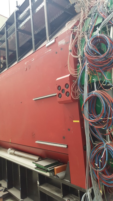

It was built in Russia in 1990. It is a big yoke of ca.4 meters in length and height (octagon). The wall thickness is 200-250mm. Like 100 metric tons
The people who make the simulations think it could be iron XC10 (1.0301), it seems very high percentage of iron (because of its magnetic properties)

RE: Steel type from a sample
Yes, the red thing:
