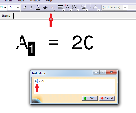

Hi to all,
I would like to add this prefix to my dimension, but I don´t know how.
At the moment I´m just adding a normal text close to the dimensions.

Hello,
Is that pic from CATIA? Do you need this in Drafting design workbench? Do you want it by script or manually?
Here is the manual method:
Hope it helps.
Calin

And here is how you do it by script:
CODE -->
Sub myText()
    Dim oDoc As DrawingDocument
    Set oDoc = CATIA.ActiveDocument
    Dim oView As DrawingView
    Set oView = oDoc.Sheets.ActiveSheet.Views.Item(2)
    Dim oText As DrawingText
    Set oText = oView.Texts.Add("A1 = 120", 10, 10)
    oText.SetParameterOnSubString catSubscript, 2, 1, 1
End Sub
Hope it helps,
Calin

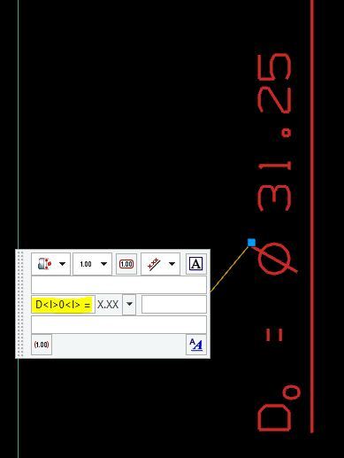

RE: Subcript text in dimension prefix
Thanks Calin,
But my doubt is in a dimension, not in a normal text.
This pic is from NX. (I´m NX designer fighting with Catia). In NX you just have to add the text between <l>text<l>
I´m doing my drawing manually, not by script.
Airin

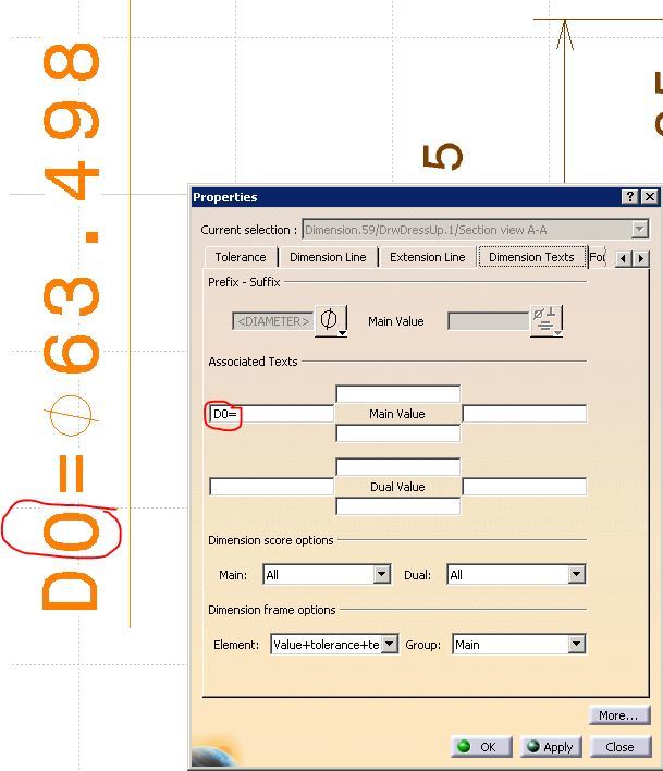

Create a normal text with << D0 = >> then right click on text -> Positional Link -> Create and select/click the dimension. Now, anywhere that dimension goes, the text will follow.
I don't know other methods.
Sorry.
