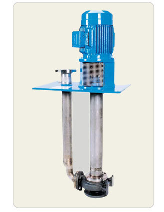

Hi everyone,
I have a sump pit (see attachment for details) that drains via a lead lag pumping system. The fluid being pumped out is 90oC WFI (water for injection/very pure water). I am taking the vapor pressure of the water at this temperature to be 526 mmHg. The pit is arranged such that the pumps are bolted to the top of the sump pit, have legs that extend into the pit and have 2" clearance from the floor of the pit. The maximum distance from the surface of the water in the pit to the center line of the pump is ~70 inches (70 inches length of the legs is by best approximate to center line of the pump given the drawings).
Pump details:
GPM = 25
Head (ft) = 110
RPM = 3500
Discharge line is 2"
HP = 3
One of the maintenance techs has noticed that this pit is pumping out slower than normal. My initial diagnosis is that the pumps were
not designed for this fluid temperature, so the NPSHr is too high (Can I get a stupid check on this thought?). The first complicating factor is that the stream of water into the sump generates a lot of steam as it flows into the and waits to be pumped out. Could the steam alone be forming a vapor lock situation that impedes the flow?
If further system details are needed, please ask and bear with me as I hunt for them. I will be on site tomorrow so I will have a better chance to get information.
Thanks,
~J

This looks to be a typical vertical sump pump:
https://www.google.com/search?q=vertical+sump+pump...
This type of pump will be a good choice for this application.

RE: Improper service for existing pumps?
jari001
There is a big difference between your photo and your drawing / schematic
Picture shows what looks like a vertical sump pump with above ground motor. Simple, effective and should avoid any NPSH issues and inherently "self priming" as the pump is below water level when turned on.
Like this:
Drawing though shows a surface mounted pump with 2" "suction pipes"
You need to first work out which one is correct.
You didn't say there were two - it could simply be that one of the non return valves is passing. Have they tried it by isolating manually one or other of the pumps?
Given that for the low level ( lower than 24") both pumps operate in parallel, it could be one has become less effective than the other and hence takes more flow, but would also mean that when only one pump is running it is probably sitting on the non return valve to allow automatic start / stop
So currently the NRV on the pump discharge is looking like a good candidate....
bimr and LittleInch have nailed it with the pump type - certainly appear to be vertical sump pumps. As suggested you need to perform a flow test on each, but you also need to identify the pump model to check results against its performance curve. Isolate each in turn, then with isolation valves open to check non return valves performance.
Flow rate might be able to be estimated by recording level transducer output over time of pumping, if you don't have a flowmeter installed, or access to a portable one. (I have measured level change on hands and knees with a tape measure, but the sketch seems to indicate that this pit is sealed).
For the lead pump, at a mean level of 18inches minus say 6inches from the bottom of the pit to get to feed nozzle, we have a static head of just 12inches of hot water at 90degC, which turns out to be 3kpa, making total pressure to be 104.3kpa abs at the feed nozzle. Sat vap pressure of hot water at 90degC = 7.4m = 71kpa abs, which leaves 104.3-71 = 33.3kpa as net suction press, which = 3.5m of NPSHa which would be typically adequate.
So there is some other problem : blocked suction or discharge check valve leaking on parallel pump ??

I was able to confirm that the installed pumps are in fact submerged pumps, Ventriflo is the supplier. I am waiting for them to get back to me with the pump curve for the model I have. Strap on flow meter is available and I plan to correlate it to the transducer level readings.
Since we are in shutdown now, I have set out a plan to do the flow testing that's been suggested. Unfortunately, the hot water loop gets deactivated for line maintenance, so I can do a room temp water run soon but a hot water run won't happen until mid/late January. I have also requested the techs disassemble the pumps and check valves for visual inspection as part of the flow testing experiment.
