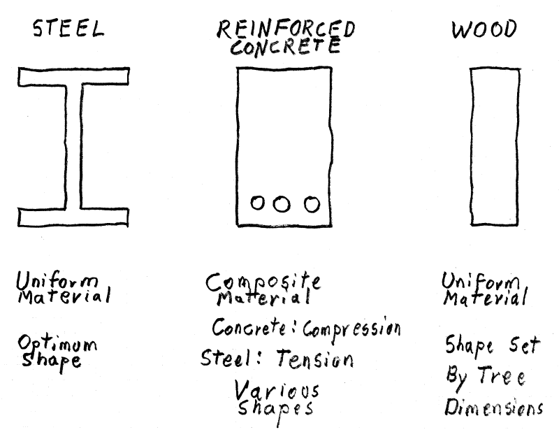

Wood is much lighter (lb per cubic foot) than either steel or concrete. By weight, wood is stronger than either steel or concrete. Compare the weight of a 12' long 2x10 with the weight of either a steel or concrete beam to do the same job.
Wood is more flexible than either steel or concrete. It is common to have a wood beam that can carry a load (suitable section modulus) but will deflect too much (to small a moment of inertia). The best way to dramatically increase the moment of inertia is to go with a deeper beam (say 2x10 instead of a 2x8).
A more subtle difference is shown in my sketch.
Steel can be shaped with flanges to give high section modulus and high moment of inertia in a beam that is not too deep.
Reinforced concrete is designed so that the concrete is at it's best (compression) and steel is at it's best (tension).
With wood, we are stuck with what can efficiently be cut out of trees (rectangles).
