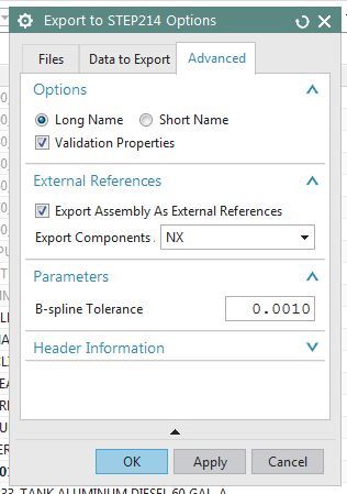

When i do that it does not export anything. The step file is empty. What other settings do you have selected under the Advanced tab.
RE: Step file that retains assembly
Advanced tab, nested not basic?
Chaz4172 Im not sure what you are asking. My basic setting are the same as shown in the screen shot posted by studiotraccani. I am wondering if it an additional setting that needs to be selected under the advanced tab on the export menu.
When i try to export entire part it doesnt export any data, the file turns out to be blank.
When i export selected bodies it flattens them into a single file and doesnt retain the assembly tree structure.
On the advanced tab ive tried selecting "export assembly as external reference", ive tried not selecting this, ive tried multiple combinations of these settings and either exporting entire part or selected bodies. Still no luck on getting the step file to retain the assembly tree information.
As for importing the step file i make sure that the flatten assembly option is not selected, so im not sure why it is not working.
I dont know if there is some other settings somewhere other than the export or import windows that i may need to change?

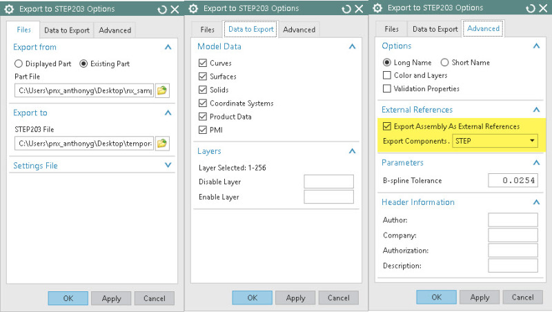

I did some testing with an example assembly I have, which has no bodies in the assembly or sub assemblies, only the components contain a body.
If you export using Displayed Part, it will not create an assembly structure when imported.
If you export using Existing Part, it will create the assembly structure when imported, sub assemblies and all.
If you export with 'Export Assembly As External References' turned on, it will create separate files (either a STEP or NX part) for each component/assembly file.
Turned off if will export to a single STEP file.
The below image shows the settings I used to get a single step file as you would like (except for 'Export Assembly As External References' was turned off).
The attached STEP is the result of that export.

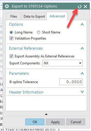

File -> Export to Step (whichever format suits), but before changing any settings, click on the reset arrow (image below shows where on the dialog to click).
Then set for existing part, tick the boxes for all objects in Data to Export.
The resulting STEP file should be aroun 3Mb.
Followed your exact instructions and came out with a step file that was only 30Kb, no where close to 3Mb.
Opening it up it looks like only the drawing border came through. No solids or sheets.

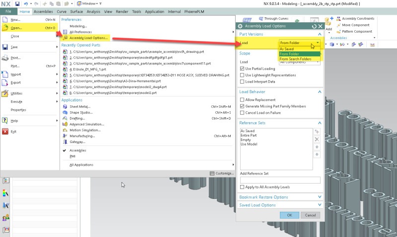

What are your assembly load options set to (see image)?
It sounds to me like it's not able to load any of the components?

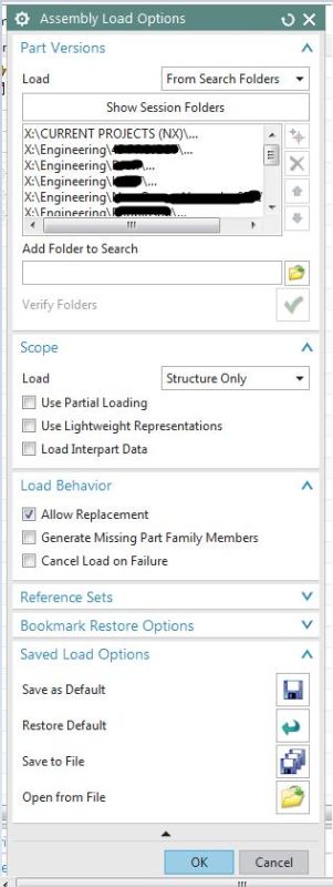

The Assembly load options is set to "From Search Folders"
The folders chosen are structured like this "X:\CURRENT PROJECTS (NX)\..."
it has all of the folders necessary for all components to open. if the load options didnt the components would load into the assembly. So not sure why it would be able to see the components
From the pic above, it looks like your load options are set to "structure only" which means it won't load the component body data. Try changing the scope option to "all components".
www.nxjournaling.com
Right after i posted the picture i went and tried just that and it worked.
Thanks everybody, really appreciate the time to help me figure this out.
We work with very large assemblies so we have it set to not open the whole thing. Didnt think that it would effect an export. But now i know
