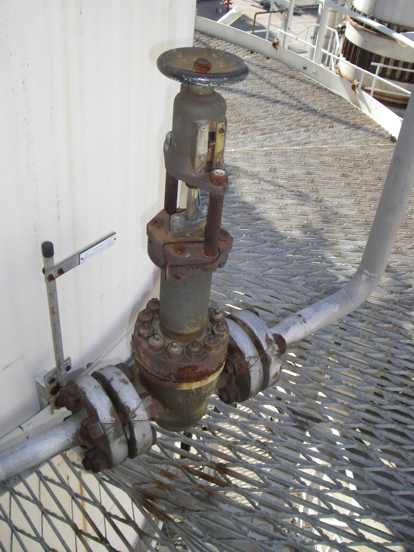

Hello.
Can someone help me to identify below valves? Class 2500; size 2". Gas.
Installed about 30 years ago. Does not work.
VALVE no 2 - maker uknown. Flanged. Seems to be globe valves but...?
Valve no 2. - EDWARD VALVE. BW. Seems to be globe valve
Many thanks and best regards.
Tomasz

Suggest to ask someone who was there when building/designing the Plant pc2
If this manufacturer limit to 30 years or older and your Plant is in Europe, I would say one of these:
Gulde (bought by Emerson) if this is the case than it might be a Gate valve. They don't produce this anymore
Neles (bought by Metso) can be Plug valve or Gate valve
HP valve --> the yoke similar to their current design, might be their trademark
Or might be one of Fisher or Flowserve portofolio.
And also some possibilities of your local manufacturer (Nederlands/German/Italy) and probably exported from USA
One thing almost for sure, the "manufacturer" will not offer like to like replacement or similar spare part due to obsolete. And will offer you up to date alternative
one of my Plant's 40 year old Gulde
Maybe someone more senior than me can provide better insight.
PS: Some Gate valve during this era were and still designed as throttling valve. IMHO, your valve is already reach end of lifetime
Regards,
MR

Danlap (MR) Thank you for your answer.
Many options...
My factory is located in Poland (EUROPE)
BW valve is EDWARD, so I suspec that the other one (with flanges)is EDWARD too - but cannot be sure. Probably gate valve.
Anyway, thank you so much.
regards
