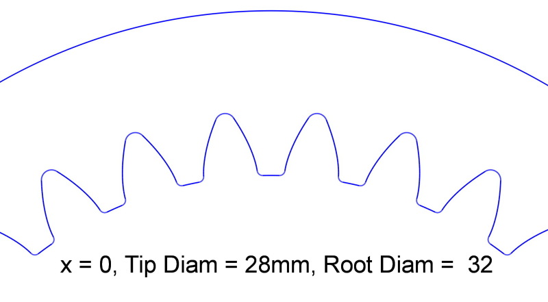

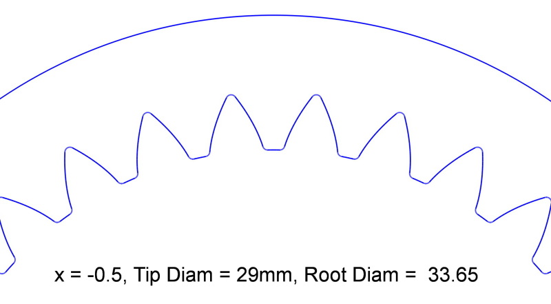

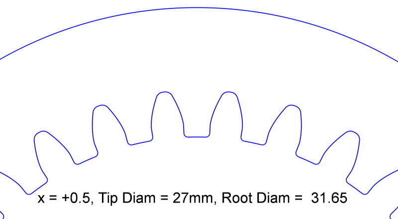

I don't have time to read your article, but using software I did get a chance to create some images showing what I'm trying to explain.
The images show that entering a + correction to an internal gear gives a tooth profile with smaller tip & root diameters.
Also; for internal tooth profiles, AGMA2001 defines x as positive when the reference generating rack is shifted out of the material of the gear [towards the centre of the part] resulting in an increased tooth thickness of the gear teeth. - http://www.gearcalc.com/downloads/manual/manualse4...

So to be clear then, for the sake of the poor OP, is it agreed that applying a negative profile shift on an internal involute profile will result in larger tip & root diameters? This will in turn, for a spline profile, produce a profile in the hub that will mate correctly with a shaft which has had a corresponding but positive profile shift applied to the profile.
I feel we've hijacked the original post so to help clear-up any confusion that the OP might have; here is all the data needed to manufacture the hub as per the DIN5480 standard.
