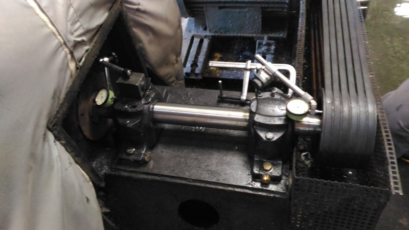

  • ronfrend: I'm just searching what it could be without any restriction. One clear things is the standard balancing procedure to reduce high axial 1X have no effect. Starting from this point every considerations can take place. I checked for the belt alignment and it was good (i used this similar laser device)

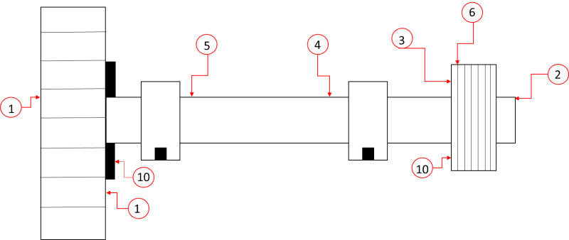

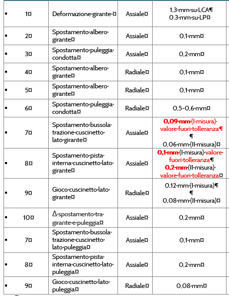

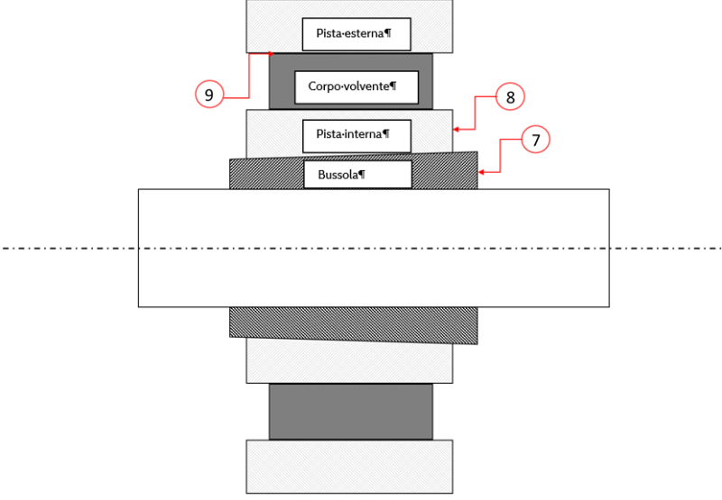

  • To clomplete diagnosis i performed some test as shown in a pictures found some values out of tolerance (in red into Table)
    There is a picture for fan, schematic where measurements done and values reported. All descriptions unfortunately are in Italian but if you have a problems to identify the mechanical parts related i can translate them.

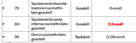

    Looks like you have an installation alignment issue on the taper roller bearings. The inner cup on both bearings and the inner race on one bearing are out of tolerance in the axial direction. If you have bearing mislignments that will give a high 1X axially. I suggest refitting the bearings.
    I did also see you have a high axial runout on the front of the impeller - is this a new unit?

    What you said was exactly my first impressions and i provided a mechanical operations to fix the problem.
    The results? worst then before; spectrum is exactly the same and the axial components are bigger (until 24 mm/s rms)than before the mec operation.
