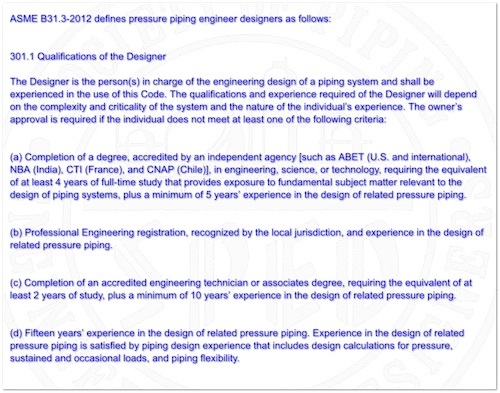

I agree that a material change is significant but then it is solely up to the designer to determine what is significant then.
RE: ASME B31.3 flexibility analysis criteria
Not a designer. The engineer that will be responsible for the design.
I think in this case the 'engineer' is the 'designer'.
