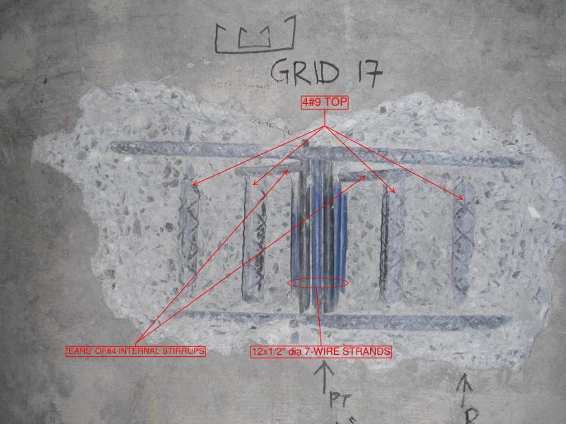

I have an mid 70's existing concrete beam that we have to modify (partial demo and amend/terminate some PT etc) and I have the following callout on the existing drawings:
The beam section is 24" x 24". I have assumed the call out of "DOUBLE" to refer to 2 sets of 2 legs for a total of 4 legs.
OR, does "DOUBLE" refer to 2 legs only?
There are no sections of the beam to verify what the original engineer meant.
Thoughts?

I think 4 legs is the correct interpretation.
RE: Existing concrete beam stirrup callout
Thanks, hokie66.
Ditto. In my estimation, the conventional definition of a single stirrup in a beam of meaningful width is a thing with at least three sides, two of the them being vertical. Confidence level = 97%.
Thanks, KootK...and I like your confidence rating. We will know definitively after we do some site work!

By way of follow-up. We did some site probing, and confirmed #4 stirrups are 4 legs, and the PT is 9 continuous + 3 added tendons.
Unfortunately, all 12 tendons are bunched in one group, of which we have to splay and terminate with new anchorages.

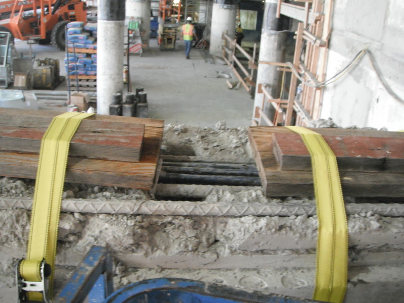

It was decided by EoR to permanently terminate/sever the PT and provide new concrete walls below selected beam spans and/or FRP to other remaining spans, due to the loss of all prestress.
We were therefore engaged by the GC to sever the PT, as follows:

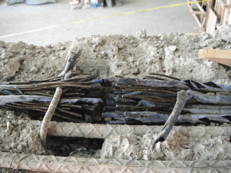

12 x 1/2" dia UNbonded strand tendons to two beams were de-stressed via a cutting with an 5" angle grinder. Tendons were approx 90' long.
Temporary wood boards were secured to beam perimeter as the top of concrete demo had exposed long-lengths of the tendons:
'Bird-caging' of strand wires upon release of prestress:
Video LINK of cutting.
No strand exited from the live-end anchorages. No spalling to beam faces due to release of prestress.

To me, it doesn't look like there was much elongation in those strands.
Quote (KootK)
Do you actually get to do real, plysical things like that at work?
I do. Typically 25%, or so, is getting my hands dirty - real dirty - especially when having to remove and re-grease old strands etc. I was the one that severed the tendons in this video. Not one to instruct another to do something unless I am willing to do it myself smile
Quote (hokie66)
Very observant. Measured about half of expected elongation recovery. When the 12 tendons were placed in one bundle, they were interweaved/twisted around each other. Coupled that with old mid-70's PT grease that typically dries out and hardens, cause significant 'loss' of recovered elongation. There were no observed intermediate CJ's along the beams length, which often is the first indicator of less elongation recovery.
