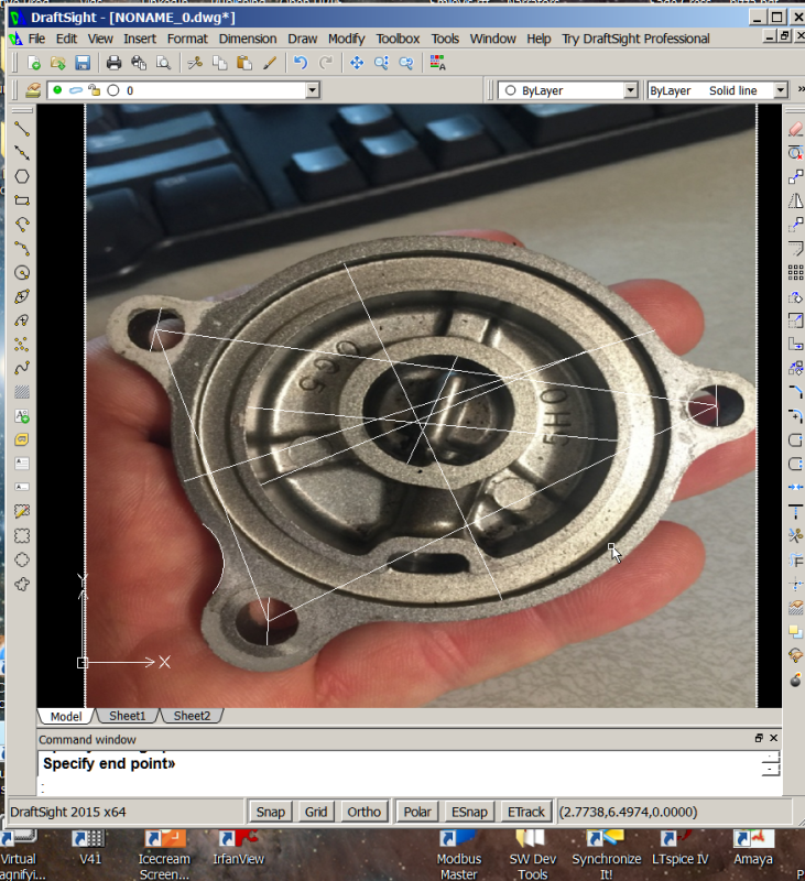

This is a case where some trickery can work well.
1) I'd toss that thing into any all-in-one printer.
2) Scan it like a document.
3) Bring it up in your engineering drawing tool as an image. In this case I'm using free DraftSight. I took your image and brought it into Paint that comes with Windoz. From there simple "insert object".
4) Expand it until it barely fits on the screen.
5) Use the drawing functions to 'digitize' all the features you care about.
Notice how I used lines across the holes? Then I used snap-to-midpoint. As I write this I recall that a superior method as discovered by the Germans for their gun-sights are to use circles. The human eye can very accurately align concentric circles. Just draw circles that don't need to even be the same size as the holes. Your eyes will allow you to accurately center them in the image holes behind them. Then snap your lines to the centers of the circles.
It is important to scan the original as I describe, as taking a picture causes no end of parallax issues as seen in my hack-job of your photo.
Once you have all the geometry you want drawn you then pick any single dimension you've drawn that can be accurately and easily measured with your calipers on the actual piece and you 'scale' your drawing to arrive at that same dimension in your drawing. All the other dimensions will, of course, automatically scale correctly simultaneously.
Notice too in the lower left I could easily use the arc function to create the same radii in things like the ears - if you care.
When appropriate you can blitz the photo image out or turn it into a 'block' move it to its own layer and turn off that layer.

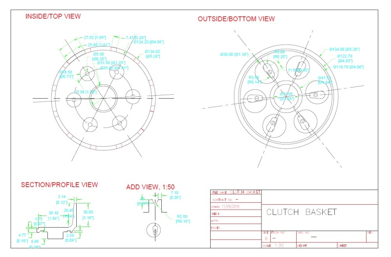

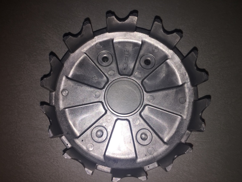

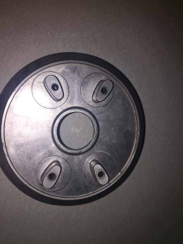

The reason for me learning how to measure correctly is that I have the real project that I have had a friend help with. It is a hand sized clutch basket for a motorcycle. She has produced a 2D CAD drawing, but now the machine shop requires that I provide a 3D drawing. Now she doesn't have time to work on it anymore so now I am stuck and thought I could learn, which I need to do. CAD software is so expensive. I originally tried Auto CAD 2017 but found that by the time I started to figure out how to do what I needed to do, the trial version would expire. Sketchup is much easier but still expires. :(
Here is a pic of the PDF that shows the 2D drawing..
And this is the original part that she measured up..
