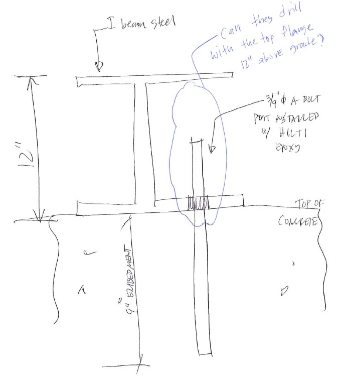

I have an I beam skid on slab. The I beam already has holes on bottom flange.
Can they drill into concrete if the I beam is just 12" high?
The top flange could be interfering with the drilling tool.
Of course they can remove the I beam skid and drill after they marked the location but can contractor drill with the skid on there?
I don't know all drilling tools out there and the clearance they require.

I doubt it. Probably best in the future to weld a plate to the bottom of the beam that overhangs the flanges. You could then bolt that down.

If you don't remove the beam, drill a hle in the top flange, on line with one below for access. Use a sufficiently long masonry drill to drill the concrete.

Depending on thickness of the flange and edge distances (as well as drill specs), you may be able to drill on a slight angle?

There is a 90 degree elbow that can be installed at the end of hammer drills for angled drilling. Not sure if the length of the drill bit and elbow could fit in a 12" space.
Drill a hole in the top flange to allow for drilling through the bottom flange.
Similar to XR250's idea, weld hold downs to the W12's and install the anchor in the hold downs.

Ok thanks. The i beam is part of a skid that is by the equipment vendor. I'm only doing the foundation. Vendor drawing showed holes on the bottom flange of skid that's why I was asking if I can put post installed anchors there.

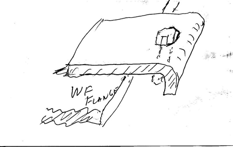

My sketch is crude, but hw about a clip that sits alongside the flange?
RE: vertical clearance to drill post installed anchor
OG is on the right track. You can use crane rail clips. They are installed just outside the flange, similar to what OG has sketched and they are made to do exactly what you need.

The crane rail clips I have seen are made for tapered flanges.
There may be some that will work on WFs, but you should check.

A corner reamer will fit but you'll need several different drill bit lengths to do it. I vote for OG's solution if you can live with the clips.

As to the clip I suggest, all it takes in the shop is a metal cutting saw, power drill, Oxyacetylene torch, bench vise and a hammer. Oh yes, start with bar stock same thickness as the flange if possible.

Eric: No welding needed. You heat the bar and bend it. Each one might take all of 10 minutes to make.
