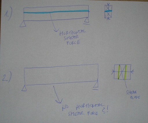

@KootK - i dont believe there is any horizontal shear there - just like in flitch beams... i think there would be a horizontal shear if you have an element on top of another, but not by the side like in this case. If there is horizontal force can you tell me where does it occur?

I really dont see how this is different than flitch beams. its pretty much the same problem/design. But with flitch beams we have a composite (no horizontal shear, just transforming vertical load by bolts to steel and its a composite). Something is missing...

Usually a flitch beam will have the centroids of all of the plies aligned vertically or close to it. In that scenario, you're right, there is no horizontal shear. However, once the centroids of the various plies are offset, as with your channels, there is horizontal shear.
Think of if like this:
Most of the benefit of your reinforcement comes about because you'll have an axial tension in your channels to help resist moment and curvature of the composite section. How would that axial force get into the channel other than through little horizontal forces delivered to it at each bolt? Those little horizontal forces = horizontal shear transfer.

Ok, I understand what you try to tell me, but how can i calculate this? How to get an axial force in chanels - axial force is actually a shear load that needs to be taken care of by sufficient bolts and bolt spacing. Right?

In detail, it's actually quite a complex thing. Each bolt carries both a horizontal and vertical shear force with the horizontal force increasing towards the ends. Most designers will design for one or the other but rarely both. And, in many instances, that's fine as one of the forces typically dominates. Aligned centroids sort of being the extreme example of that: all vertical, no horizontal.
Quote (n3jc)
Exactly. You calculate it by doing the same VQ/I calculation that you'd do if the shear planes were horizontal. In your case, Q will be based on each individual channel.
You'll also have to run the calculation using using a transformed area cross section to account for the fact that your steel is stiffer than your wood. You could just convert your channels into equivalent wood rectangles, maintaining the height and vertical location of the centroid but allowing the width to expand.

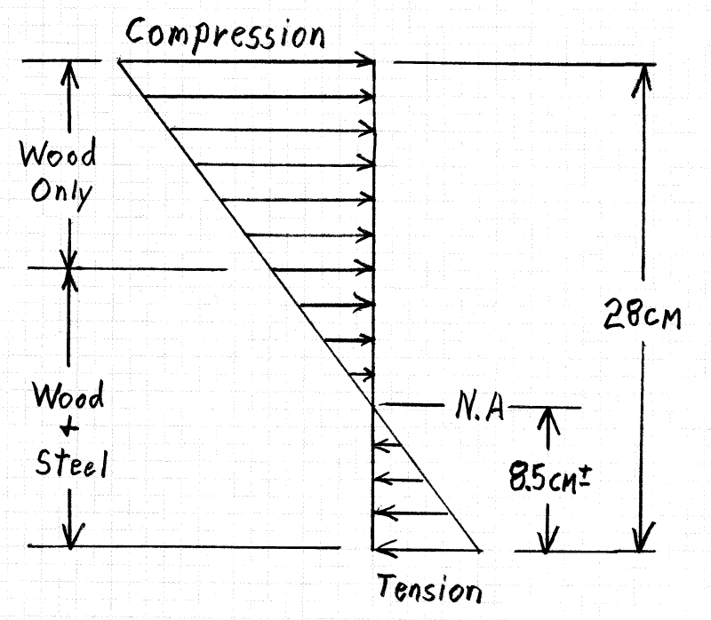

n3jc - There is a problem with your calculation of the location of the neutral axis. KootK mentioned that the steel is usually transformed into equivalent wood section - this was not done in the calculations. In this case, it is easier to transform the wood into an equivalent steel section. The neutral axis is going to be located at an estimated 8.5 + cm, not at 13.6 cm. See the diagram below:
The diagram gives a clue to another problem - there is not enough steel in the compression area of the composite beam. Compression bending stress is going to be more than double the tension bending stress... and the only material located to resist it is wood. I have not performed the calcs, but you should. IMHO, any significant loading of the composite beam will have the wood overloaded / failing in compression.

SlideRuleEra yes, there is mistake in my calculation when calculating position of centroid. An entire cross section has to be from the same material, so you need to do it on transformed section (all steel in this case). You need this when checking if stresses in materials are OK.
But when you are calculating shear force (tau) you are using I and Q for an actual cross section (wood + steel), not on transformed section, right?

Quote (n3jc)
I'd do it on the transformed cross section. Otherwise, you would need to find another means of accounting for the fact that the channels' greater material stiffness will draw more stress towards the channels. Basically, you'd need to base I and Q on areas multiplied by respective E values. No big deal but no easier than transformed sections.
