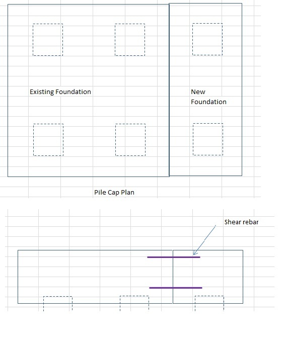

Hi Everybody,
I have a existing four pile cap, It was decided to add two more new pile and join to the existing foundation by
Hilti epoxy Rebar. It is joined by the shear rebar as shown in the figure.
(a) Rebar transfers the shear force from the two pile cap to the existing pile cap at the joint.
(b) If she shear is taken by the shear rebar, what is the length of rebar to be embedded in concrete?
(C)If all the shear is transferred by the shear rebar, the concrete at the joint should also have enough shear capacity ?

Sounds like a shear friction application to me. As such, the bars would need to be fully developed either side and the concrete check would be two fold:
1) Shear friction at the joint.
2) Regular diagonal tension at the joint.
Your design should also consider any other forces present at the joint. If there is significant moment, you'll want most of your rebar on the tension side. Hilti has some great resources for the design of these kind of joints,

How the load is applied to the pile cap is important. A single point load (say, a column) will have different requirements than a load disturbed over the pile cap surface (say, a machine).

ok my shear rebars are sufficient for all the forces in that joint. However, pile cap thickness is not sufficient to carry shear is it ok. note that existing pole cap thickness cant be increased
