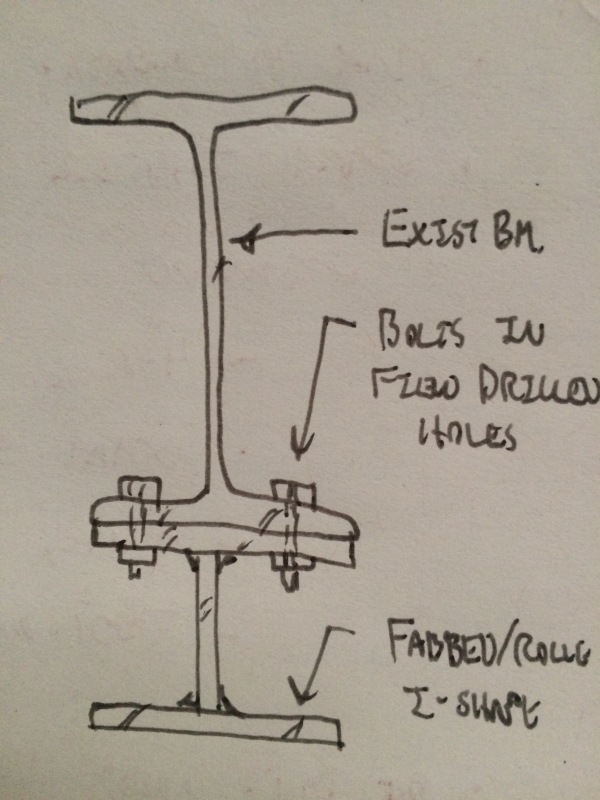

If there's access etc, wholesale replacement may well be the way to go. Whacky alternative shown below. Maybe slip critical bolts.
RE: Beam retrofit
do you guys like putting in hundreds of bolts like that ? I thought you preferred to weld ?

Oh we much prefer welding to bolting, but I think the OP stated it may be difficult to obtain permission to weld since there is often flammable material around. Koot's detail may not be that bad, but field drilling all those holes may be difficult to make overhead.
