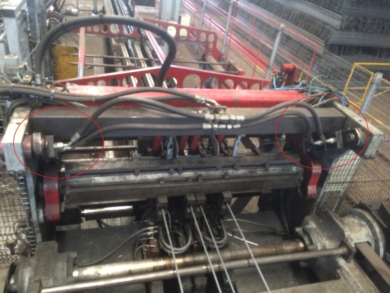

This is the system that I'm talking about. As you can see there are two cylinders that are connected by the transversal red bar.
That problem is when one of them extend faster than the other one. With that, the transversal bar wear up, until it crack or break.

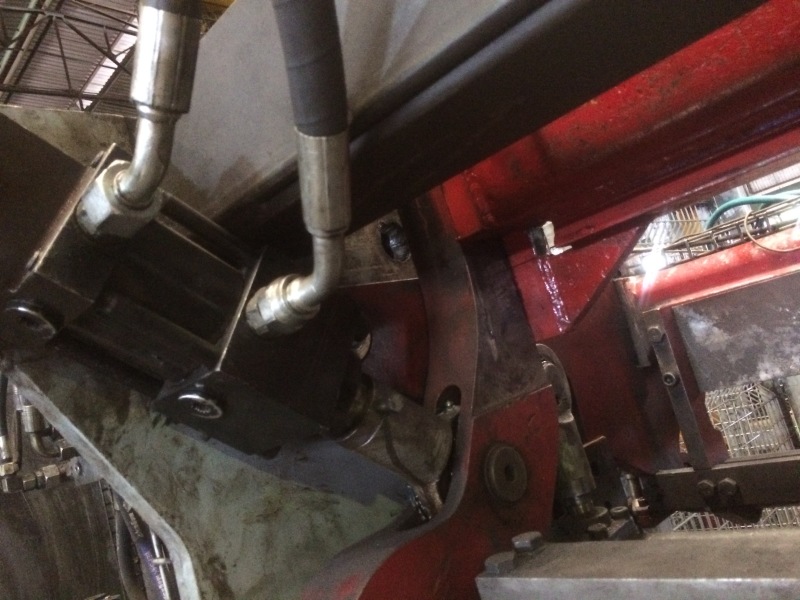

Also with the image you can see that the cylinder do not accept the magnetostrictive linear sensor.
That picture helped?

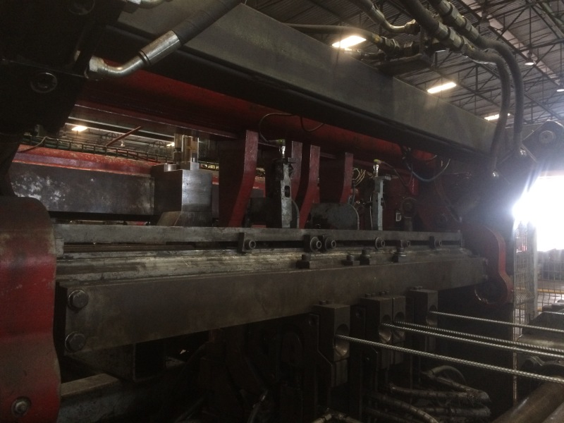

Some more pictures.

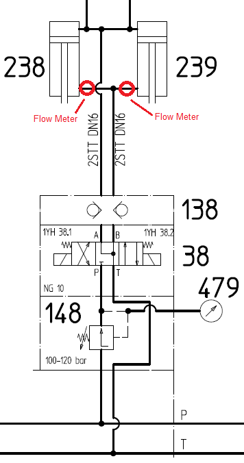

What I want to do is something that will notice that the two cylinders are not working in synchronism, is not that they are not working now, is that when one of them don't work properly, it will cause damage to the structure, leading to a wear of the transversal bar, and I want to avoid this.
Researching I notice that there's no flux divider after the valve, so what I want is to install one to certify that the flux is equal to either cylinders.
But when it has an internal leakage caused by wear of the seal, they will still extend at different speed. For that what I want is to install two flux meters right after the tank connection. Thereby I can measure if there's an increase on the fluid returned to the reservoir. And I can electrically stop my machine preventively (like the image below).
RE: Cylinder Delaying
Flow dividers can make things worse. You need to add a connection to allow the cylinders to equalize the cylinders or the flow divider error can accumulate. Right now the pressures are equal so the forces are nearly equal (based on cylinder area)
The differential movement can only due to differential external loads which are resisted by twisting of the cross bar, which looks substantial. Differential movement of the rods will be a symptom of external loads. Note that side loading on the rods is considered external to the pressure inside the cylinders.
The biggest concern I see is that the mechanism is too constrained, so if the rods aren't exactly parallel there is nothing that allows the cylinders to conform and this will apply a side load to the rods. This side load can bind and produce differential movement. I assume the machine is very well aligned, just a suggestion to others building similar devices.
