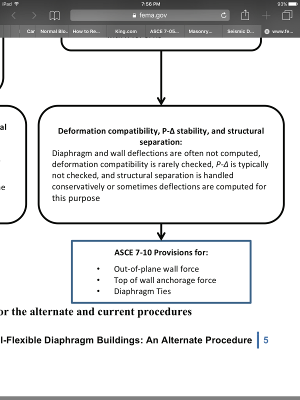

I'm anchoring a masonry wall to a flexible diaphragm. I've calculated the anchorage force per ASCE 7-10 Section 12.11.2.1 as 0.4SDSIekaWp = 5.4 kip. If these were concrete anchors, ACI would require either: (1) a ductile failure mechanism, or (2) design for the amplified seismic load (a.k.a. overstrength). The masonry code does not hold me to any such requirements with regard to anchor design. The IBC does not either. Should this connection be designed for overstrength?

The force derived from that equation corresponds to the peak roof acceleration, so essentially the overstrength factor is already included. Additional amplification is not necessary.
From FEMA P-1026 Seismic Design of Rigid Wall-Flexible Diaphragm Buildings:
"In ASCE 7-10, Section 12.11-1 and 12.11-2, ka and Lf account for diaphragm flexibility. If a diaphragm is rigid, Lf equals 0 but if it is flexible, Lf equals the span length. For many buildings with rigid walls and flexible roof diaphragms, the diaphragm span between supporting walls or frames will be longer than 100 ft so ka will often be equal to 2.0. For diaphragms in which ka equals 2.0, the acceleration parameter used to compute the out-of-plane wall anchorage force is 0.8SDS, which is 80% of the maximum design spectral acceleration parameter. The intent is that the wall anchorage force is resisted elastically for a force level computed using the maximum design spectral acceleration. The 0.8 factor is included to recognize that some connection and member overstrength may be relied upon to resist the top of wall anchorage force [SEAOC Seismology Committee, 1999]."

Found this reading though decker's doc. It's one of the steps of the "conventional" method. Hard not to feel some twinges of guilt.
RE: Masonry Wall Anchorage
Thank you Deker. You've answered my question.
