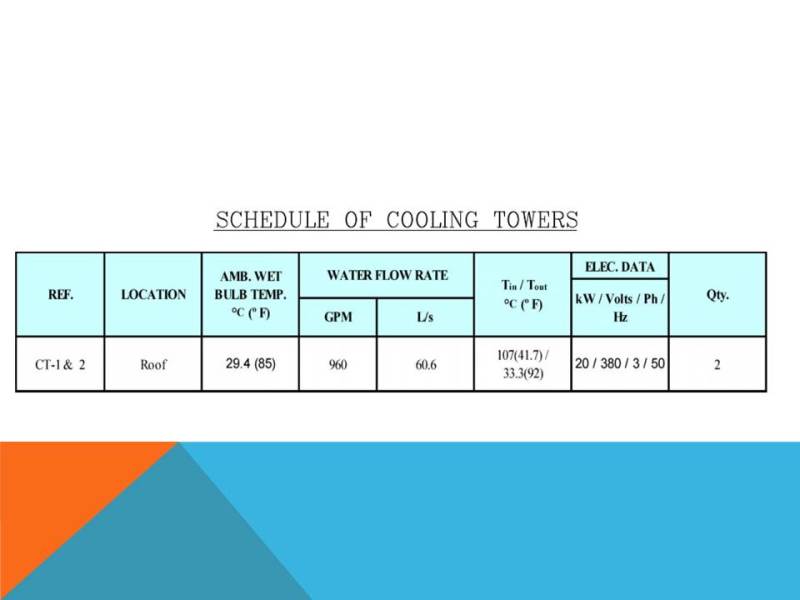

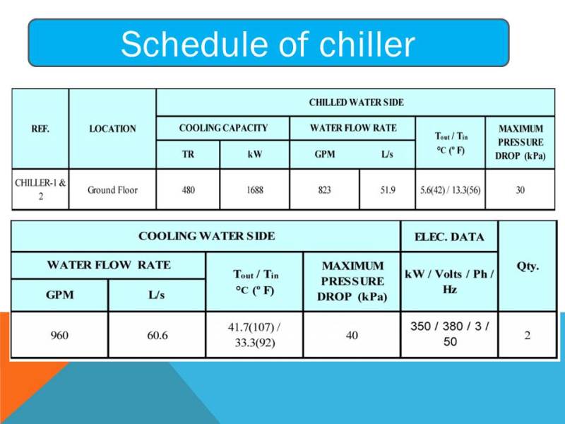

Our two buildings, assume building A and B. equipped Mitsubishi centrifugal chiller. The electrical consumption in 2015 as below mentioned. Capacity is approximately same. Now I am taking details to analyze the reason the huge consumption for building A. I already conducted the primary survey on building A. I found the building automation is out of order. Chilled water delta t is not maintained as design. (In building B also, the automation system is out of order). Now I am collecting all details to find out the cause. The problem is the same operation quality follows for two building. Except the condenser pump is placed in building in ground floor.so its power is high compare to building B. I will update more details. Your any comments on this really appreciated.

EnergyProfessional:960-ton total is capacity.960 gpm with two pumps. I have attached chiller and cooling tower details that copied from as built drawings.in, Dubai, ambient temperature will reach to 48c, wet bulb mat reach 93F.
Now winter started here, chiller works now in part load, delta t is 3.7f in chiller and CT range is 3.7F.

LittleInch : This centrifugal water-cooled chiller, red is water-cooled condenser. Both buildings are in same orientation. Both are five-year-old building. “ What are you using for tonnes to kw consumed?”-what you mean?

You listed design Delta-Ts but what are the actual Delta-Ts? Also, does one system have glycol and the other not? What about set point temperatures, are they both the same?

Now the building load is low, the system works in part load. Actual delta T is 3.5F.i have planned to check the actual water flow rate in all pumps. also send the enquiry to carrier, train for submitting theier proposal for a chiller plant manager.

Do you have any idea what the actual delta-Ts are on a design summer day? Given that the two chillers were designed at different temperature differences, the energy consumption may be able to be explained justdue to poor delta-T. Building A was designed for higher but may in fact be getting a lower temperature change than Building B.
Are these systems primary secondary, and if so, how do you maintain the primary secondary flow relationship?

BronYrAur: I am still waiting for the log sheet in summer (august) from my contractor. they would provide me soon. now the contractor fitting water meter in make up and blow down line to understand the actual water consumtion and performance of the ct.
