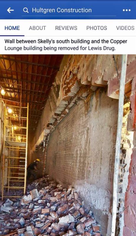

Here's a photo of the wall in the process of being removed (between the two buildings to open them up to one space.
It doesn't look to me to be properly shored at all - either the wall or the floor above. Wow..just wow.

That is a frightening photo, possibly showing the man who was killed. Any idea who took the photo or why?
RE: Bldg Collapse in Sioux Falls, SD
Are you freaking kidding? Quite clearly a load bearing wall, no appearance of shoring of any kind. I hope the contracting company is charged with everything possible.

Something tells me that Hultgren Construction won't be so proud of that picture now.

The site by wannabe also had a lot of photos, including a couple towards the end inside the same section as that in the photo of the man knocking the wall down.
Its taken me a while to figure it out, but the photo by JAE appears to be looking into the two buildings from the main street with the coopers lounge on the right, hence that triple skin wall is holding up the rest of the building.
The rather light weigth trusses are holding up the roof which existed between the coopers brick building and the next building along the PAve building.
It would definitely seem as if it was that wall which collapsed, unsurprisingly as most of it had been demolished.
Utterly criminal behavior.

Holy...not only a load-bearing wall, but being taken down from the bottom up, by hand...almost guaranteeing a catastrophic collapse.

It looks like there's a wood stud wall to the left of the scaffolding. I wonder if this was their attempt at shoring...

The developer stated that he had no experience with this type of work (sound familiar?); the construction company has no structural plans, and no building permit. How is something like this happening in 2016?
