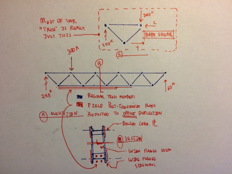

RE: 50 ft long truss beam with a 300 kip point load
I've proposed an idea below that may have merit given the nature and scale of what you're doing.
- give consideration the the possibility that it may only be the deflection immediately below the 300 kip load that matters here rather than the midspan truss deflection.
- I've suggested post-tensioning the bottom chord. The big advantage of that is that you can tune the tensioning rods in the field to drive the truss upwards and offset the deflection which seems to governing your design. That may get you some meaningful efficiency improvements.
- You'd have some extra compression in your top chord of course but also less bending.
- In terms of pure material quantities, it would probably be more efficient to harp the post tensioned rods up towards the supports. Doing so would probably introduce some costly connections at the direction change, however. Doing the straight PT shouldn't add all that much fabrication cost. Some erection cost though.
- Like my colleagues here, I'm a big fan of the weak axis WF chords. In addition to the praises already sung, it might facilitate the easy delivery of the monster load into into the truss. If you're interested in taking it that far, let me know and I'll elaborate.
- Considering clearances, it may be more constructable to put the tensioned rids outboard of the bottom chord flanges. I'll leave that decision in your capable hands.

@Deker: I watched that video for the first time yesterday. It was excellent, thanks for the recommendation.
@Bowling:
1) No sweat. Tech debate is usually fun for me.
2) I read a book on post tensioning steel things a while back and have been obsessed with trying it ever since. So there's a bias at play.
3) Bumping up the steel is definitely an option but I took OP's intent as being to try to reduce steel weight.
4) In many ways, precamber would do the same thing. Precamber has two disadvantages however:
A) Given the load, I'm envisioning a structure above being transferred out. Some folks, including me, don't like precamber for controlling deflection at transfered elements. The lack of precision and predictability in the camber can cause issues for the erectability of the steel above. With the post tensioning, one can dial up the prestress incrementally as the structure above is constructed and control the result with some precision by measuring it.
B) Precamber affects the final position of the truss but not the amount that the truss actually deflects. Thus, camber wouldn't decrease the moments in the chords where I feel that the post-tensioningg would as the post tensioning could be used to lower the deflection experienced by the truss.
