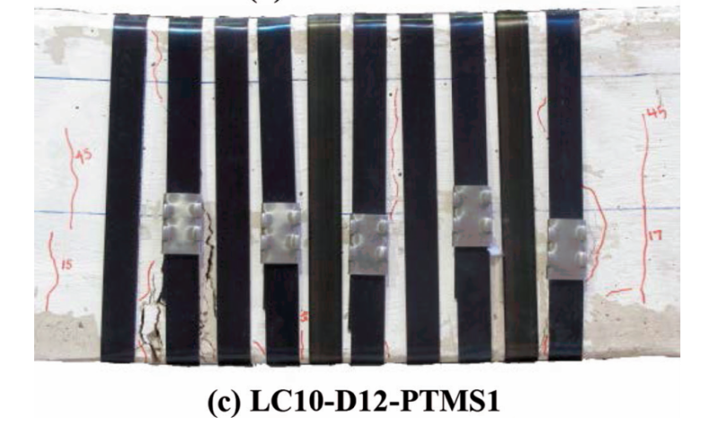

I received my copy of ACI Structural Journal (V113 #6) this week and noticed this research paper: Bond of Substandard Laps in Reinforced Concrete Beams Retrofitted with Post-Tensioned Metal Straps: Link
Damn, looks like a 'Band-Aid'.

Neat. Perhaps you'd know the answers to some of these questions based on your read:
1) Can it be shear reinforcing too?
2) Do they speak at all to fire proofing or tampering?
3) Accurately prestressing something in the field isn't easy. Just yield 'em?
4) The benefit to lap splices as one moves away from the corners must drop off?
RE: Post-Tensioned Metal Straps (PTMS) - aka 'packaging strapping'
...let me read it first. I got attracted by the pretty pictures!
I shall get back to you. I too took issue with fireproofing, and vandalism etc., and having to make slots in the slab overhead to gain access - because how often do we in the real world have rectangular sections without a slab.
