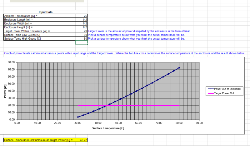

For this kind of problem you need to just pick a water temperature, find the resulting outer surface temperature, and then see if the total heat transfer adds up with the chosen temps and is in equilibrium or not. If not change your temperature guess and try again. You will need to make assumptions like uniform temperature distribution around the circumference and throughout the water in the pipe to make the calculations easier.
I have created spreadsheets for similar problems (a box of unknown surface temperature but know dimensions and power output with only natural convective heat loss) in the past that cast a wide net on temperature guesses and then interpolate the results to find the correct value.
If you don't want to automate it so much just put all the formulas together in a spreadsheet and keep changing the input temperature until your heat out and heat in match.
Here is a screenshot of the example I talked about, I use this as a quick first order approximation to determine if power dissipation within a device is going to be an issue or not:

Thank you for the input. I was already leaning toward a "goal seek" sort of solution. Please correct me if I'm over-complicating the problem, but, since there are two unknowns with only one equation, why wouldn't I end up with a family of answers, rather than a single unique (Tw, To) pair?

I am assuming you can find equations to tie To and Tw together so that guessing one will give you a value for the other. This may not be the case. Things that will complicate your calculations will be any heat transfer to water/pipe further down the line that is not exposed to the sun. If not then you may need to specify a grid of (Tw,To) values instead and try and find a best fit value based on that. In that case I would think there would be two sets of valid solutions (one with Tw>To and one with To>Tw) and you will have to pick which one is most likely to be the case.
