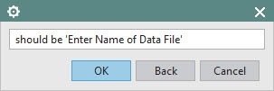

Any idea why I can't see the input prompts? ('Enter Name of Data File','Select Curve','Have You Selected the Correct Curve?')

Hopefully you can
Because now you have the two DO loop
The original one from 1 to numpts
And the new one from numpts to 1
Now you need a user choice input
and an IF statement to run the original DO loop
Or the new DO loop
To do this I need refresh my grip knowledge
With no promise I'll try to.
RE: JohnRBaker Pts_Along_Any_Curve_to_txt-file.grx
Thanks to your help, it's working fine.
The input window has no description.
It's just for user friendliness.

Thanks again a984928. That failed compilation I'm afraid.
My only problem is that the title bar of the user input gives no description - ('Enter Name of Data File','Select Curve','Have You Selected the Correct Curve?'). It still works fine, but it would be nice to see the correct prompts.
I currently have it writing the points in both directions.
The prompts are on the Cue line
