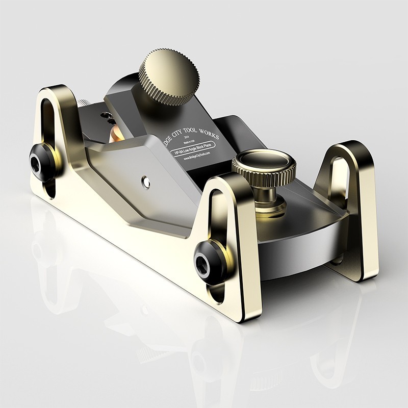

RE: hand planer
this one is so tempting...
RE: hand planer
Taken as sculpture, I can see the attraction.
As a hand tool, maybe a bit less so, because of the tiny thumbscrews and no obvious place to push on it.

RE: hand planer
budget is always a constraint.
RE: hand planer
Bridge City stuff is definitely more of an art... but you DO get what you pay for (you just pay a bit MORE than what you need).
I have a cheapy Harbor Freight plane for quick jobs (like removing the bottom of a sticking door)... now THAT thing is finicky for blade setup.
