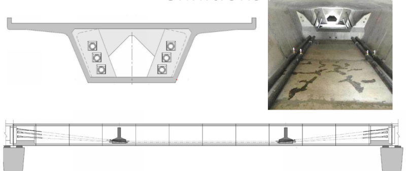

There are multiple elevated spans of a concrete guideway system for steel wheels on steel rail for the currently under-construction light rail system. 2 tracks, electric cars, 20 miles in length when complete, with 21 stations. Near all are elevated guideways. Most are match-cast precast segments with epoxy joints and PT. Constructed on temporary pier-to-pier erection trusses.
A typical section and elevation:
So of the 1500+ tendons in the project to date, less than 12 have had some grouting/water/corrosion issues. Several of which were replaced by the contractor.
The owner and the contractor have engaged specialist consultants, Wiss Janney Elstner, and Exponent, respectively, to provide root-cause analysis and materials testing etc.
The project, generally, has been controversial from the get-go. It is grossly over budget, behind schedule, and short of funds. Even the current Head of School at UH Civil Engineering has shared his views and unsuccessfully ran for mayor a few years back, on the ‘no-rail’ platform.
But I have never seen this before: The following (see Link for better resolution, from the SE's local PAC website) was authored by a local Structural Engineer in the interest of public safety and "to inform the public of possible catastrophic collapse". At his personal cost of $17,000 he ran this advertisement in a weekend edition of the Honolulu Advertiser newspaper – the only local newspaper - on 10/30/16.
