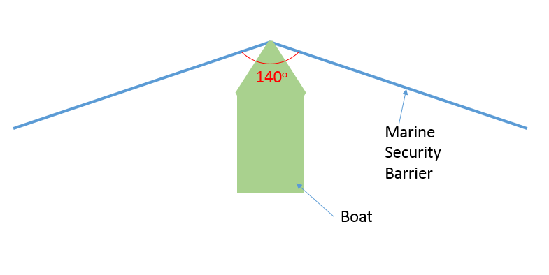

I'm trying to figure out how to use an object's defined kinetic energy to determine if its collision with a wire will break it, assuming the wire is weaker along its length than at its mounted ends. The real scenario is a motor boat with a KE of 40,000 Kg-Meter (shouldn't the doc's specs have this in kg-m2/s2?) is ramming a marine security barrier, and I need to figure out if the components in the marine barrier system will not fail. See image below of the security barrier system for concept.
To simplify my scenario I'm assuming my 19mm weldless end links are the weakest components in the system. They are made of AISI 1035 carbon steel (link for a materials property sheet I found: http://www.azom.com/article.aspx?ArticleID=6540). I'm also assuming the boat to be a "blob" that sticks to and combines with my system at impact, so that it doesn't skip and just graze the system. The barrier is not a taught line and I'm assuming there's enough slack for there to be a 140 degree angle in the system before it becomes "taught" by the boat (see image to clarify).
My initial path was to find the strain energy required to break my end links, but I'm uncertain how to do this as I can't find the AISI 1035 carbon steel's modulus of toughness and I don't know how to apply the referenced material properties into my strain energy in terms of the normal strain energy equation Ui = ∫V2/(2E))dV.
Another path I was thinking of, which seems improper to me due to the principles in the mechanics of materials, is finding the boat's impact force and seeing if this force is great enough to exceed my end link's UTS. Here, I'm uncertain of the slow down distance and not feeling comfortable to assume this figure.
Am I on the right path and can you help me? Should I be attacking this problem from a different angle?

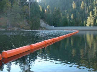

The cable is a spring element and the floats will tend to transfer energy to the water as they shift from their original position to the point contact position.
RE: Object X rams a wire. Does the wire break?
The floats will greatly slow the boat before terminal tension is reached.
The greater the angle the less the tension in the cable and end-points.

Research log booms for dams. They are typically designed to restrain drifting logs. I worked on the Greenlake Dam and I don't remember who designed the log booms but they were designed much simpler - however they were considered an expendable "last ditch" element and they were isolated from the drinking public.

Big boat with near-vertical but deep bow (ferry, ocean-going ship) will trap the wire and floats, then expend energy slowing down the ship by stretching the bable, then begin pulling out the anchors, and (if the anchors don't break loose from the shore pilings) then breaking through the line.
Small boat (typical lake or pleasure boat) will ramp up over the cable and floats, then probably "trap" the cable between boat and outboard motor propeller. Which will then suddenly stop the boat and snag the boat as it slams it down to the water while pulling out the outboard and flipping up the motor to a traveling position. Cable will not likely break at all if greater than a 1/4 inch wire rope.
Large boat/pushboat/river floating industrial craft - These have a modestly shallow draft and a long flat bow with a lot of overhang. The push boat/"towboat" will go over the wire and floats very easily and not be stopped at all until the push boat's far deeper draft and propeller/shaft/rudder snag the wire many minutes later. Wire will break and eventually will wrap around the propeller shaft and cause minor problems. Barges and towboat will not stop for any realistic wire diameter and anchor design.

If I'm assuming the boat to hit the chain in the diagram in my opening post, then each side is 1/2 of 40,000 J, or 20,000 J.
Using geometry I have 20,000 / sin(20 degrees) = 58,476 J of energy acting against my chain. This is well below the requirement to break my chain!

I don't understand the 1m bit and I don't understand the 20 degrees bit either.
