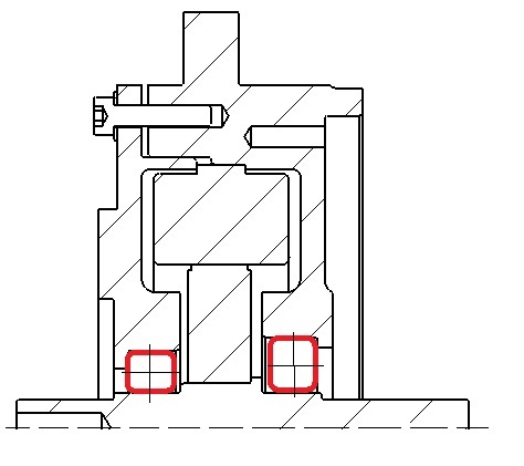

Hi All,
Perhaps people can help me with a debate we are having at work.
See picture.
My colleagues are questioning what Datum A brings to the table for the positional call-out on the ∅37. They argue that referencing Datum B should suffice for controlling the concentric relationship between the two bores.
From a functional perspective, the Datum B bore houses one end of a shaft bearing. The datum A face is a spigot/location diameter that abuts to a mating part in the main housing. I want to ensure all bores are concentric. I'm also trying to convince them that using an actual concentric tolerance is not necessary and inspecting it is pure evil..
I thought that having datum A introduces a perpendicularity control. A separate thread here: Link describes something similar and I can follow the train of thought in that post, but i'm having a hard time applying that logic to my example.
I've seen it many times where a positional tolerance for a bore references a perpendicular mating flange face.
We work to ASME.
Thanks all.

Hi All,
See shot below of part in context.
Bearings are in red. Housing in question on the left.

Based on the latest assembly drawing, my vote is B (RFS) primary and A secondary.
Ø78mm feature is driven so locate/position this to DRF (B RFS promary and A secondary)

Quote (R1chJC)
It would probably help if you explain your goal in more detail. Your context image doesn't show anything mating with the diameter 37 bore in question, and it's not clear what else may have been left out as well.
If there are screws clamping the flange down all around the circumference, I'd be very surprised if datum feature A only makes contact on the single highest point.

Thanks for the replies.
To clarify, the external flange does not clamp down and contact the external face.
The 37 bore houses a brushless resolver stator. The resolver rotor mounts on the shaft.
Mounted between the bearings is a Motor, the rotor being on the shaft and stator clamped in the housing. I want these and the resolver running concentric.

Based on the previous posts, I would leave the controls as is but add flatness control to datum A and a perpendicularity to datum A to the 22mm cylindrical datum B

The part will be oriented by datum feature A and then located by datum feature B because the bearing is probably insufficient to fix the orientation of the part.
If the bearing is sufficient to fix the orientation of the part, then it would negate the ability to clamp the middle piece.
If the latter is true, then this is a problem for the stress analysts to determine if the tolerance stack produces unacceptable forces at assembly and unacceptable internal stresses.

The question is: is datum feature A "big" enough to orient the part in its proper orientation in the assembly. This feature (Datum feature A) looks small to do a proper job (in the picture looks like also it is chamfered or has a radii for an easy assembly).
What is the physical reality of this assembly?
Not necessarily what the designer wish for, but what is actually happening.
I still say that the datum feature A is small "enough" to NOT do a proper job.
Datum feature B looks much bigger.

Datum feature A is indeed quite small. Since the ∅78 is a close sliding fit (i think the housing is a H7) then wont that have the largest influence on orientation? The end housing will slide into the bore until it hits the highest point on Datum A, any small 'wiggle' in the fit will be taken up by flattening out Datum A face onto the motor shoulder.
What would be the effect of removing datum A altogether and just referencing Datum B for positional? Maybe I just need a flatness control on the Datum A face as mentioned by mkcSki?
