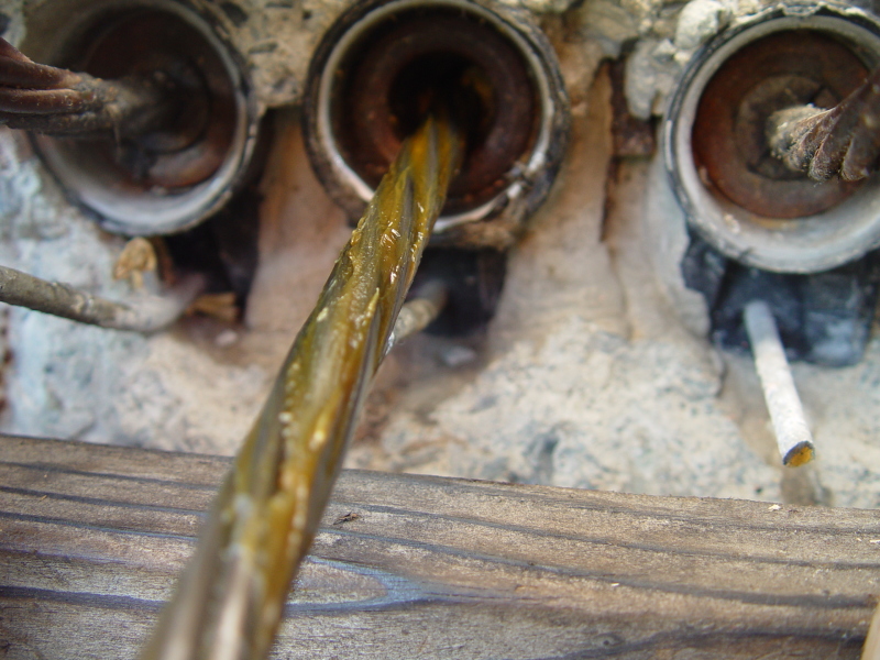

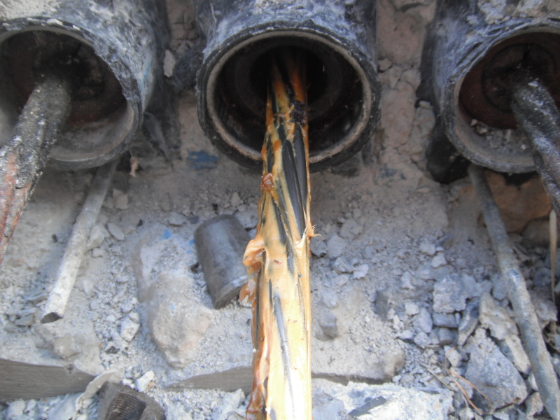

A bit off topic: I will add that we often take grease samples from tendons and have them tested for water content (ASTM D6304 or spectrochemical analysis) and compare them to current PTI specifications for maximum water % (currently 1000 ppm). We have projects from as recent as 2008 come back with water contents of more than 5 times the current specification, due to water ingress through non-sealed live-ends.
High water content grease is usually easy to determine visually due to emulsification:
Good grease:
Bad grease:

Excellent photographs. I appreciate what you say about the older greases and overall protection. I have been periodically investigating problems with p.t. corrosion since about 1986. The problems I have seen have all been with the "push-thru" type sheath. I have not to-date seen problems with the extruded type sheath, which did not come into general use in my area (southern Ontario) until roughly about 1992. I believe that the extruded type sheath came into use in the U.S. quite a bit before it was adopted in Ontario. Even the extruded type sheath can admit water thru the ends or thru the inevitable cuts in the sheath that are made on site by dragging rebar over the sheaths, etc. I insist on no void system with watertight end encapsulations. When we tested a claimed water tight end encapsulation we found it was not quite watertight--the manufacturer then went thru several cycles of tweeking the encapsulation and re-testing for water tightness, and eventually got it right. "Trust but verify".
Unfortunately, the post-tensioning industry was not very open about the corrosion problem, in my opinion, which may account for the relatively late adoption of extruded sheath system in my area. However my current situation is directed to tendon sheaths that were grease injected a few years ago in an effort to increase the tendon durability (not my idea).
