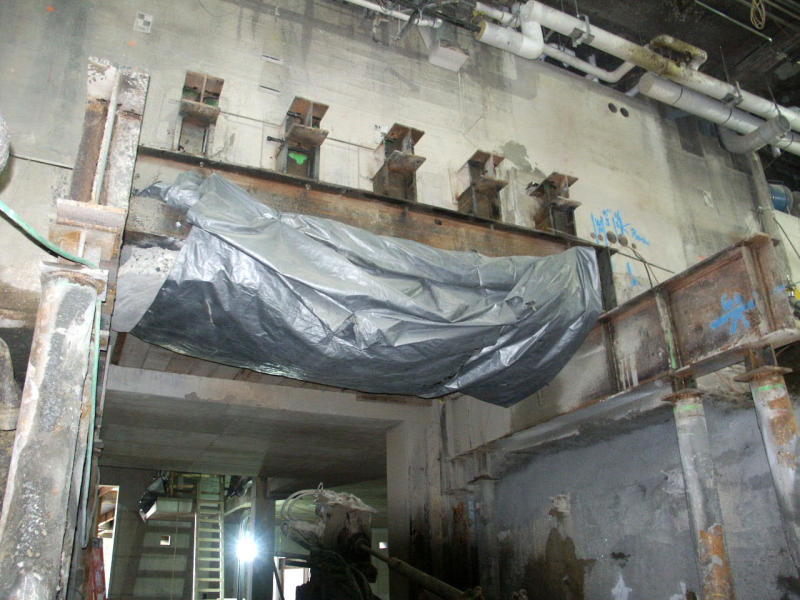

This may be slightly offtopic, but hey!
I don't see a lot of unreinforced masonry, so I don't really have renovation experience with it. What's the actual construction sequence for putting a new hole in a wall? From a design standpoint, you could presumably just design a new ledger beam at the top of the hole... but how do you actually make the hole and build the new beam without the wall collapsing down on you?
RE: I was disheartened when I read this line:
Depends on the size of the opening:
1) For a small opening, you'll cut a pair of angles into the wall to function as a header and then remove the block below. Similar for plates or channels bolted to the side of the wall. no matter what you spcify, there's a pretty good chance in these situations that the mason will just remove the block ahead of installing the header and, for the most part, the block above will just kinda hang there in tension.
2) For larger openings, schemes like needle beams can be used as shown below. The one shown below is more complex than usually required but you'll get the idea.
I assume if the contractor wants to be cautious he would use needle beams with adjustable shores to cut the opening and implement the new lintel, but there are other methods as well. I don't think that you can design the new structural elements without considering the alterations to the existing structure. That's my issue is how to prove that the changes we are making will not effect the performance of a structure that is already not in compliance with modern building criteria.
Quote (KootK)
...there's a pretty good chance in these situations that the mason will just remove the block ahead of installing the header and, for the most part, the block above will just kinda hang there in tension.
Seconded this; it's been about 50:50 in my experience.
