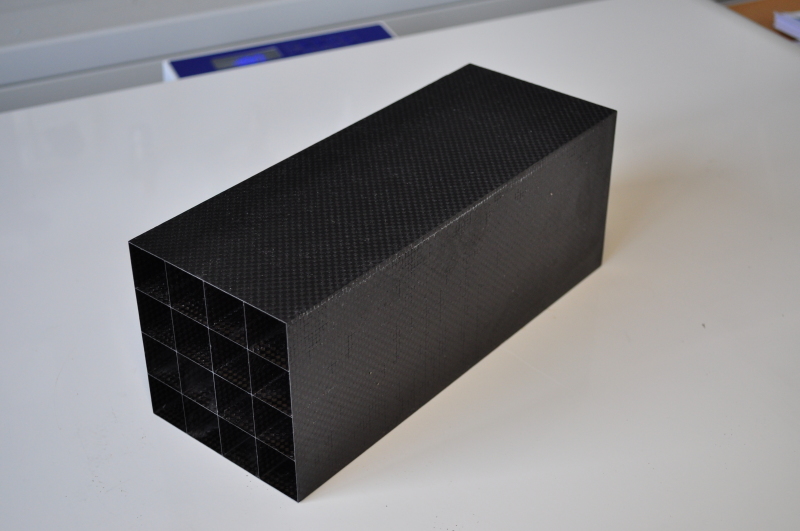

Here a picture of one part we produce, carbon fiber coming out of a mould:
We have moulds with very high accuracy and we want to measure the result (this part was sent to a company to be measured and the measurement cost around 1000 euros)

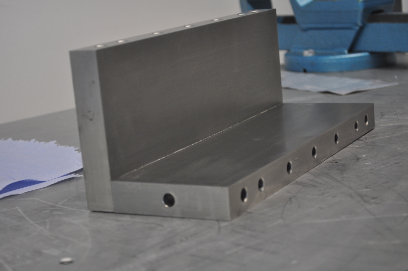

Here half of the mould (when full it has a square shape). We need to measure it when mounted to see if the mechanical workshop did well their milling work
If we want to see how flat are the faces, also how much perpendicular; I understand we need CMM

Something is horribly NOT flat in that last picture.
Seems to me there are several ways besides a CMM for measuring flatness:
> laser or mechanical profilometer
> dial indicator
> optical flat

in the inner faces of the "L"?
RE: Metrology equipment for lab
The near left and rear right corners are off the tabletop, so either the table top is not flat or the part is not flat. There's a lot of FOD on the tabletop, so that could be it as well.

This is the part with the aluminum cores held within the depicted steel jacket during a heated cure.
Generally, measuring flatness with a granite plate, a height gage / indicator stand and a dial indicator would be easy. Perpendicularity can be verified using a machinist's square and a feeler gauge.
However, since you haven't specified the precision you want, there's no way to know if a cheap setup can attain that goal.

The costs involved with a CMM are probably far greater than you imagine. With the composite part shown, it is often acceptable to inspect the tool and a first article produced from the tool using a controlled process. The subsequent parts are accepted based on use of the controlled/validated process and the qualified tool.
