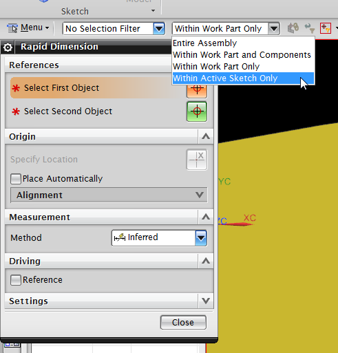

NX9 - Sketch - Rapid Dimension. Can't select Datum Axis as Second Object
RE: NX9 - Sketch - Rapid Dimension. Can't select Datum Axis as Second Object
Does the "Selection Scope" allow you to select objects "outside the active Sketch" or is it set to "Within active sketch only" ?
Regards,
Tomas
Yes,
Select Second Object was "Within active sketch only",
I've changed it now manualy to "Within Work Part Only".
Was easy,
many thanks Tomas
