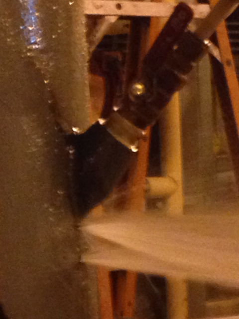

Injection is done with quills that place the chemical near the center of the pipe. If you have both acid and caustic injection those will be separate quills because different metallurgy is required. Don't go cheap on the quills, if they fail the acid will be injected along the wall of the pipe and eat right through it.
Just experienced this first-hand a month ago. Turns out the quill was too short and only protruded into the water steam about 1/2". Mixing water and sulfuric acid that close to a steel pipe wall doesn't bode well for the steel.
Photo is just water spraying out but not really an easy fix since this header can't come offline without taking down a whole lot of other equipment...
