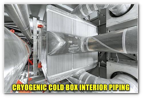

Then again, maybe I'm going senile and misremembering. I seem to recall the competition touting the use of stainless steel at customer installs but don't know how that worked out in the long run. On the production side (air separation and liquefaction plants) piping was all insulated, ducted or VJ SS with mostly aluminum equipment with explosion-fused Al/SS joints inside the cold boxes.
"Most LIN lines use type K copper pipe here in the US as opposed to XS 304L which will be much more expensive."
http://www.eng-tips.com/viewthread.cfm?qid=81664
(Of course, in the image above, the box interior is filled with perlite under operating conditions)
