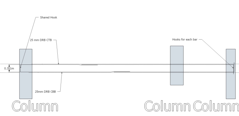

is it okey for a continuous top(CTB) and bottom(CBB) bar to share the same hook .. ( please see image bellow ) , what section of the code prohibits or allows this kind of detailing . . please check the length of hook if valid..

The detail you posted is too small for my eyes, but it looks like a 180 degree hook which is permitted by ACI for bar development, but you can't double dip and use it for developing the top and bottom bars simultaneously.

I simply wouldn't use a shared hook for the reason that bar placement is easier if you allow them to place the lower layer of bars first and then come back to chair up the upper layer of reinforcement.

1) I know of no code provision that pertains directly to the development of U-bars.
2) I think that most engineers, in many situations, would consider U-bars to be a better development situation than a pair of independent hooks. I know that I would.
3) For flexural applications, it's unlikely that you'd ever have both sides of the U-bar in tension concurrently. As such, you may not really be "sharing" the hooks in any way that matters.
4) As others have mentioned, the detail presents constructibility challenges.

Im not designing .. but I was just building the tie beam... ( i forgot to tell you that it is a tiebeam )

As long as you have the development length required, there is no reason that you can't use a shared hook; I've done this for anchor rods numerous times. There is an issue of constructability that comes to play and it may be more costly than the added steel. It may assist with development in tighter spaces. I'm not aware of any code restrictions.
