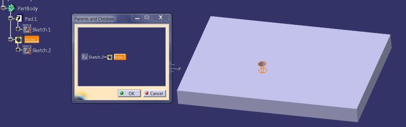

Let's assume i have a hole , and a macro that i'ts painting this hole the color i want ( i allready made this ) , now i want to propagate the same color at all the matrix, and function linked to this hole.
Can this be done?

In the image bellow you have the Parent/Children of a hole. What does it mean for you matrix? Are you looking to color all holes in a part with same diameter with the same color? Can you give more details?

what do you call Matrix.1 a Pattern? If you can get active body, check all shape until you find a pattern and check patternObject.ItemToCopy if it return your Hole...
BTW You're talking about a Hole, but you search for Threads... not same object in CATIA,and your search won't find hole with thread definition included, but will find thread operation applied to Hole, but not the one in the pattern.
When you do Hole with thread definition and Pattern it will also pattern the threads.
When you do Hole (no thread) or Pocket, then Thread it, make sure you select both the Hole and the Thread for Pattern.
now that you have either threaded Hole or Hole/Pocket + Thread, you get the active body and loop all shape and check thepattern.ItemToCopy.
As I am looking into it as I'm coding right now, I can see limitation here as ItemToCopy will return only the first selected object, so in case of Hole/Pocket + Thread, it will not work for you.
So Methodology would be to use only Threaded Hole and not Hole or Pocket + Thread...
Not sure if ThreadAnalysis API i available, or maybe Parent/Children API...
Good luck

Thanks but probably i'v been misunderstood. The code i pasted is just a parte of a code that is rolling and looking for holes/threads/diameters etc..
So i really don't need this kind of "differentiation" the software will make this for me , i would just like to know if there is a command to call for children.
Once i have the desired hole selected. I need a comand to select it's linked matrix, like the screen i'v posted.

easiest way would be like I said, scan all feature in solid until you find Pattern, then look at .ItemToCopy remember the limitation that it will work only if the selected object is the first on the list.

Having the matrix selected and launching the comand .ItemToCopy in the macro i'm not giving me the hole. Wich is the syntax exactly?
UPDATE.
I managed to make this work but further consideration i strictly need something from "holes" to they'r "matrix" is there no command for that?
Like there is for products? ( children )
